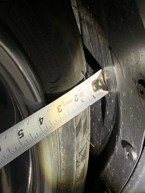

I may have a unicorn, but a 305/35 rubs the front liner on a staggered 11” front. They wore/blew four different push pins off besides scraping my liners. I have told you, written you about that. Shared pictures with you to help you. Oh, also the rear front liner catches some rub also! That is why I just unexpectedly spent over $1,000, on shorter tires. Why else would I do that and remove $1,000 of perfectly good tires? 305/35’s will only work on the OEM 11” wide wheels on my car in the front.
Frustrating? No. I just don’t like repeating myself multiple times. Now you want info and you want to debate what I have told you AND TOLD BIZ in public? ASK biz why he was so worried about a 12” front, and only made one wheel for fit. Ask him about the confidential photos I sent him.
Here! No longer confidential, you want public info.
Here everyone, here is a picture of a 325/30 BARELY CLEARING when you turn the wheel. Note the rub - scraping marks from a 305/35. It got even worse last year and I could not allow it to continue. This was taken early last season. You stagger out an 11” wide custom wheel too far (to match a 12” wide rear) or use a 12” wide wheel up front and this may happen to your car with a TALL 305/35!
Go look at where your 11” wide front sits relative to your 12” wide rear. Same spot - staggers out to look right. Go for it. Others can help you.

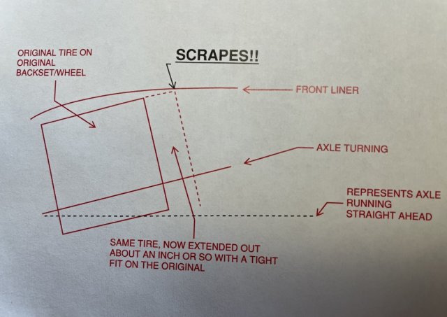

9,020
54,664
For the visually and mechanically challenged. Sometimes a diagram of a problem helps.
