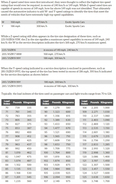

It depends. Do you want to retain the capability to travel in excess of 186 mph safely? I haven't looked much at the 305 stuff yet, but on my old narrow body car I could only find ONE tire, other than the stock offering, that was available in the stock sizing, rated 186+ (as opposed to rated UP TO 186) and also had the correct load rating (load rating on the narrow body is "106" and on the widebody is "107"). That tire was the Michelin PS4 (not to be confused with the PS4S...which I was not able to find in stock sizing). The PS4 had better traction and met all other criteria but developed a terrible back-n-forth oscillation under heavy acceleration when speeds climbed above 80mph. So I went back to the PZero summer tire. I also wanted to stick with the stock sizing because at the time I wasn't interested in changing wheels and I wanted my sidewalls to stand correctly instead of being bulged or poked.
As I said before, I don't know whether another tire exists for the 305 section tire that also has a (107Y) speed/load rating. And that may not matter, to a lot of people it doesn't. But I didn't want to give up that capability so I was in a tight box.
You may already be aware of all of this, but it took me awhile to figure it all out. Hoping the info helps.

HJR,
Some good information! I've ordered some Michelin Pilot Sport 4S tires for custom wheels for my Hellcat REWB - hopefully they will be shipped soon. Deciding which tires to try on the new wheels was a journey down tire information lane - and while I spent a lot of time looking for whatever reasons I did not read a clear explanation of the nomenclature you've listed pertaining to the load rating, or the speed rating.
I'm getting the 4S tires in front in size 315/30-20 on 11" rims custom designed to accommodate the six caliper Brembo's. This is a little smaller diameter tire than my stock all season Pirelli's. The Michelin 4S tires are labeled 315/30ZR20/XL (104Y) on the michelinman.com webpage. You said the Z is left in there to connote "in excess of 149 mph", and the Y after 104 means "in excess of 189 mph", which is great although I'll never get there. The 104 load rating of 1,984 lbs...well, dang it, you've said my car should have tires with a 107 load rating of 2,149 lbs. These 104 load rated tires do have XL (there are two models for the same size tire - not sure why). I got this below off a website explaining XL;
"Reinforced or XL (Extra Load) tires are specially reinforced tires. They can carry heavier loads than tires of the same size. Reinforced tires are designated on the sidewall by the letters "RF"; extra load tires with the letters "XL." Reinforced and XL tires require higher inflation pressures than standard tires."
Am I making a mistake in not ensuring any new tires have a load factor of 107, or perhaps higher? Does it matter if I'm not going to put four people and a trunk load of stuff in the car? How about running the car hard on a road course? Questions, questions...they never seem to end. Turn over one new to me subject rock and there are ever more questions.
I imagine a sharp lawyer, if I had a blow out on the street and hurt somebody, would say I was negligent in not ensuring I had 107 rated tires on my car.

I think I answered my own question. HJR, you are correct the stock Pirelli 305/35-20 tires on REWB Challengers have a load rating of 107.
But, it was an option to buy the summer Pirelli 305/35-20 tires and they have the 104Y rating.
https://www.tirerack.com/tires/tires.jsp?tireMake=Pirelli&tireModel=P+Zero&partnum=035YR0P0
I must be on solid ground getting any close sized tire with a 104Y rating.

I have the stock summer Pirelli tires on my widebody and they're (107Y).
HRJ,
I swear...just when you think you got something understood!
With regard to the Michelin PS4S tires and that michelinman.com link where I got the 104Y info, I noticed there are TWO listings to "buy" 4S tires - for what would appear to be the same dang tire. They do have different model numbers, but everything else about the tires seems the same. No separate load index ratings on that buy page - the load index ratings if they are different aren't displayed. So what's that all about??
ARE there two models of your summer Pirelli tires - one model rated 104Y and another one 107Y? Why would a company do that? Someone seeking to buy OEM replacement summer Pirelli tires could easily forget about, or not know about, the 107Y rating and buy what looks exactly like their OEM tires on tirerack.com - but rated 104Y. That might present a safety hazard.
Fast forward to the confusing scene of a purple Challenger Red Eye Wide Body, previously loaded with people and some luggage, consumed by fire by the side of a road. The people are standing there looking at the car and their belongings burning up. They all have agreed the car seemed to have had four simultaneous tire blowouts for no apparent reason. Bits and pieces of rubber sidewall behind the car support this assessment. Fortunately for them, the simultaneous explosive blowout of the tires kept the car going straight down the road, sparking 4th of July-like sparklers while grinding down the newly purchased custom wheel rims of the avid Hellcatforum.org member - until the people could bail out as it screeched to a smoking stop. Unfortunately, the prolonged sparking inside the wheel wells ignited oil fumes emanating from an aftermarket oil catch can *nod to DGatzby's catch can thread*, which had ruptured from the combined shock wave of the exploding tires. The impressive catch can oil fume fire had rapidly spread via ruptured brake fluid lines to engulf the entire vehicle.
Ambulance pulls up, followed by ambulance chasing attorney. He looks at the scene, turns to the owner of the car and says, "Looks like the county is going to bill you big time for those 300' long furrows your wheel rims dug in the asphalt, plus the giant melted spot where the car lies. I'm a liability specialist!"
He looks over at the passengers. "Any of you suffering? Any aches and pains? Any emotional trauma? Expecting any long term ill-effects?"
They all nod eagerly. He turns to the owner and says, "I sure hope your tires had the correct load index rating. If not, you're f*#ked! Insurance won't cover it."
The owner looks shocked, and then says, "They were 104Y rated high performance summer tires! They can go faster than 186 mph, and I was only doing 60!"
The attorney says, "I know cars. Your car specificed 107Y tires. It's called negligence, Mister." He turns to the passengers. "Any of you feeling so poorly you're anticipating long term trauma, and would like to seek punitive damages for negligence?"
They all nod eagerly. The attorney peers again at the burning hulk. "Is that a catch can I see?" The owner slowly nods.
"I thought so. More negligence! I always tell people they're NEVER worth the extra 37 horsepower."
There's a PZero summer tire in 305/35/20 with a (104Y) speed/load rating that was developed for Ferrari. Not exactly sure which model. The (107Y) version was developed for the fatass Hellcats that we drive.
The attorney says, "I know cars. Your car specificed 107Y tires."
To be completely accurate........"(107Y) tires". Parenthesis are important in that context. ;)
Those parentheses are critical. That's the "over 186" indicator...
