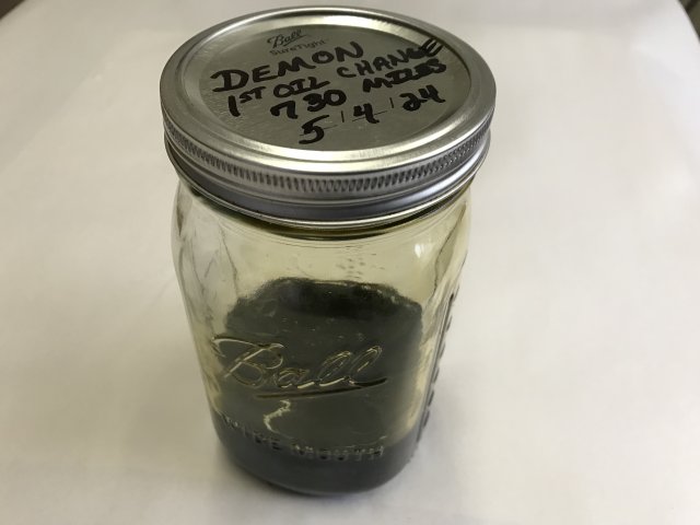

IS NOT what you want with the someone deciding weather a questionable engine has issues, or is worth purchasing, rebuilding, putting more good money into bad motor…..etc. I did save a portion in a Mason Jar Just in case I somehow got lost in the laboratory documentation system, or want a secondary analysis. While this may seem a bit excessive I would rather be cautious until the swirling questions behind the 170 die down and reliability issues prove different. In my opinion it will.
Mason jar of oil appears dark and difficult to establish actual clarity of oil, so I tipped jar momentarily and snapped pick for oil clarity on upper part of jar. Yes the perspective is not nearly as comprehensive as Speedy with his great videos “(keep those coming they are appreciated, very thorough and well edited) “ but Mason Jars are cheap and a pic takes only seconds. Not to mention saved samples at intervals are available to Dodge if ever oil condition comes into question for auditing. IMG_8493.jpeg IMG_8493.jpeg

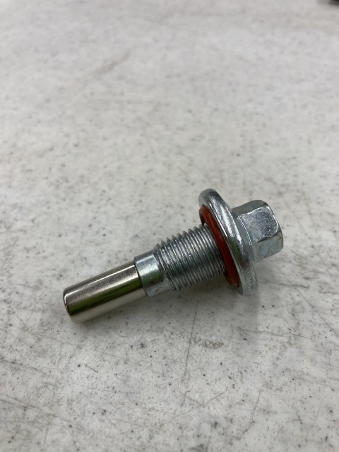

The guys on the other forum have convinced me to make up a batch of super magnet oil drain plugs, they fit all 6.2 engines. If anyone over here is interested PM me and I’ll put you on the list. They pull in particles from 6” away, keep ferrous hard debris out of your oil pump and bearings as even the best oil filters don’t catch everything, these do!! Even my blower lifting eyelet I dropped and couldn’t find, the magnet in the pan grabbed it!!

Wonder why the oil is so dark? Break in oil?
Mine was darker than I expected too.
View attachment 139531 View attachment 139532 View attachment 139533
those magnets will pull satellites out of orbit if you arent careful.

I like it, any risk of the magnet ever coming loose?

I would be up for a magnet or two. Put one in the RE. Thanks for thinking of the group Mike!

Yep, I agree with dark tint but it’s almost a greenish hue. I would expect 2nd change to lighten up in color. I’ll take that over Metalic Flake Brown any day.
