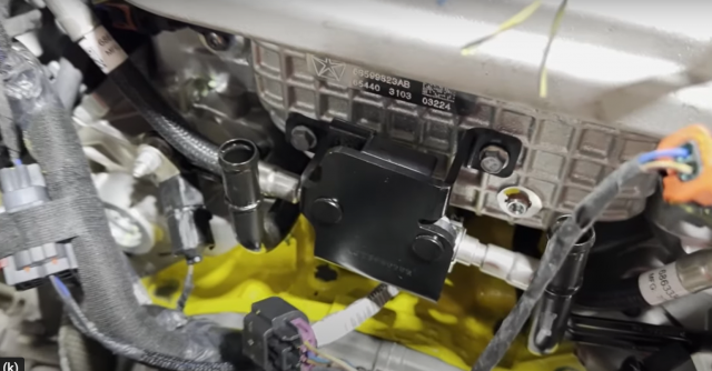

Found info on the actual ethanol sensor. It is NOT the sensor on the fuel rail. It's mounted to the back of the blower.
Looks like a GM sensor. We need the part number!!

4,078
I will try to get a scope light and capture part number image it is a bitch getting back there. Cowl comes up real tight towards blower lid. I think best to go in from side by rocker box covers with flex scope and capture part # if it’s there to read.
