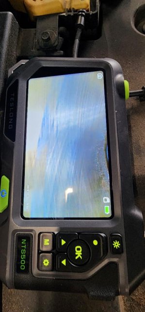

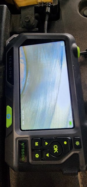

I do some wrenching but I’m not a mechanic by any means should get some more info tomorrow but here are the results from the borescope and compression test.The only thing I noticed was Crank and cam wave pattern was checked no by the tech. I asked for the diagnostic tests to be done for piece of mind since at the time nobody at the dealership seemed to know what actually happened to my car.

I would caution you on demanding a re-paint of the front bumper, I mean it's almost impossible to not scratch the underside up a little over time and those are pretty minimal marks. I only say this because the odds of an exact paint match and it looking perfect are low in my experience.

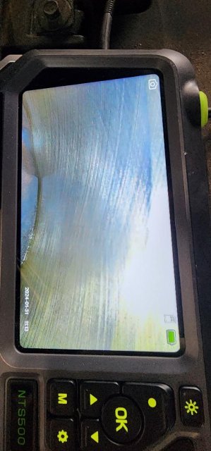

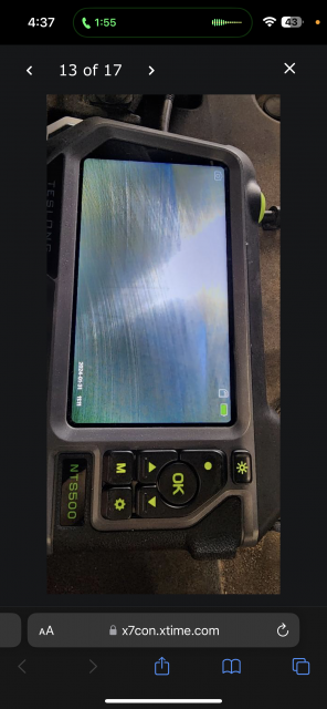

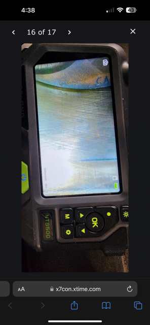

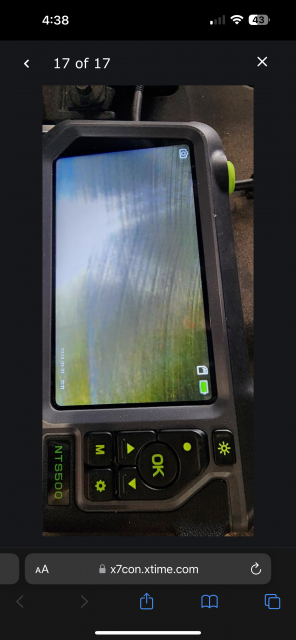

Update 7/1/24
Dealer sent pictures of bore scope and clearly sent pictures of a different car, date on photos is from January 31st of 2024 and engine bay looks nothing like mine. Waiting on blackstone kit to send out sample. Scheduled appointment for a second opinion.

That's really shady ...and stupid.
