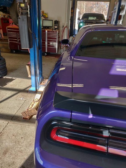

Yeah, I wouldn't let a dealership's employee anywhere near my car. When I purchased an oil filter from the dealership I didn't even drive the hellcat to the dealership, felt like bad karma. When I got home from purchasing the oil filter I noticed it was full of dust. The dealership didn't even give me a box, it was just the filter that was probably sitting on a shelf for years.
I then ordered a 2-pack from HHP, which I highly suggest, scored the correct SRT oil from NAPA, went to my mechanics shop and we lifted the Hellcat and proceeded to do a proper oil change. He was unaware of the secondary oil filter drain plug, but I showed him and he was caught off guard. We drained the 1/2 quart or so and refilled with 7 quarts.
