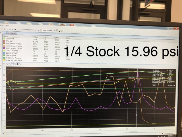

I hope I don't come off dumb with this post. I'm looking for help here and I am concerned since I bought the car used and don’t know it’s history
From what I understand from online research and watching Speedys youtube video is Boost is measured Manifold Air Pressure - Baro.
I only have a 2.85 pulley how am I making this much boost.
This would be 16.33psi DA was +800
This screenshot was -400 da but still 17.61psi on only a 2.85
When I do the math from above pressures I get 16.33 and 17.08 psi, that totally in reason with a 2.85, no belt slip with a tight blower in good air. That’s right where my original 2016 blower was.

What’s your max timing set to?? I was able to run 14 degrees on 93 and made about 785 wheel at 16.5 psi of boost with knock sensor voltages staying under 1600 millivolts.
3,752
8,905
Add some more pids to your log

Also, You need to look at baro and manifold pressure at the same time frame not just peaks as baro changes a bit as you drive around

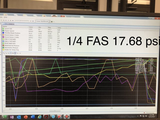

Here I have attached 2 logs the first was before we ended up pulling timing the second is after we pulled timing
You will also notice I hit 87% injector duty cycle. Making this extra boost may be putting me in an unsafe spot.
I was just about to go do another pull but my laptop is dead. It'll have to charge for a bit.
What injectors you using??

Demon injectors. I’m wishing I’d just done id1300s and went flex fuel next winter as a winter project.
