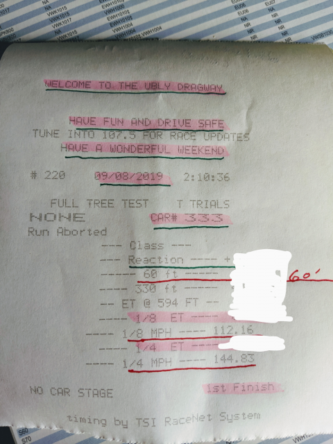

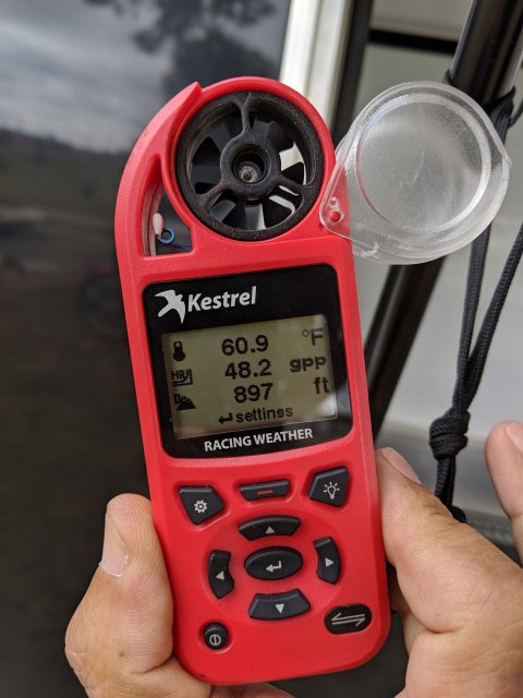

Yesterday, we got our first taste of decent air (+900DA) in the red-eye. We are on the cusp of trapping 145 mph in the quarter mile at full weight with a 28 x 10.5 radial. No nitrous. Stock engine and stock blower with stock pulleys running E85.
We knew the car would need to back half around +33 MPH to get there. Those of you who study incremental know how big of a deal this is- especially in a nearly stock car running injectors and a tune. Many did not think this was possible, but here it is...

Times redacted?

Times redacted?
Still working on the other incrementals...

Wow - picking up almost 33mph on the back end in a stock boost car is insane, I don’t care what fuel you’re running!!

Wait...
Are you saying you trapped 145, and that this is +33 from your stock trap???
Surely not, right?

33 MPH gain from the 1/8 mile mark to the 1/4 mile mark.

I'm saying the car is picking up 33 mile on the back half. Subtract the 1/8th mile trap speed from the Quarter mile trap speed. The difference is the back half gain, which in this case is almost +33 MPH. Folks who know how to measure real power use these two metrics ( 1/4 mile trap , and back half gain) as their power "bible". In other words, this is my dyno...

These 2 numbers and the weight of the car will tell you how quick the car should ET. Once you have a car that makes power like this, you then work on the other incrementals to get them where they need to be so they correlate with the 2 main metrics.

Agreed. My stock Demon has an increase of around 27 MPH in great air, so 33 MPH increase at this time of year is huge.
