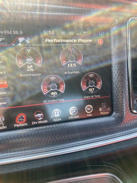

Thread Starter #16

6,595
You’re just getting the sputter out of nowhere or what?

memphis
Thread Starter #18
When the chiller is on and it’s cold like that cruising on the highway,that’s why I believe it’s the condensation in the supercharger causing it to sputter
It could be, but had it always done it or did it just start doing it?

memphis
Thread Starter #20
Just started when I put everything back to stock
