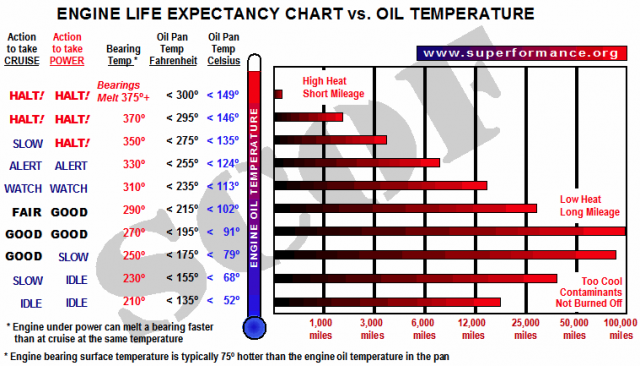

Not a Redeye, but I see in excess of 270 oil temp at the end of a 20 minute track session.

"Does anyone else see their Redeye heat up to a 228-230 degree water temp after a cold start before it allows return to about 200 degrees?"
I had not noticed an up and down coolant temperature cold start behavior. I just ran a test, for what it might be worth. Parked car in dry garage, 72 degrees OAT on car dashboard sensor, probably 100% humidity because it is raining and steamy, brand new 7 quarts Pennzoil 0W-40 Ultra Performance oil, new SRT filter, hood closed, two high ceiling fans on, one floor fan not directed into engine but alongside car towards doors, two garage doors open.
Time in minutes from cold start 0003 0006 0009 0013 0018 0020 0023 0028 (beyond 28 minutes time all parameters stabilized)
Coolant temperature 130 163 195 204 212 213 221 224
Oil temperature 96 114 143 184 204 213 212 210
Oil pressure 62 57 49 48 47 46 46 46
Couple of observations - front side fenders hot to the touch after shutdown, and...I was surprised the oil temperature got to 210 after 28 minutes almost all at idle RPM. I did rev the engine twice, briefly, to 2,000 RPM, at 18 minutes and again at 23 minutes. I'm thinking it could be normal for the Red Eye coolant to get right up there to 230 before coming down. Usually when I'm cruising around easy on the power and going 45-55 mph coolant is steady about 200 degrees. I discovered there is a 120 second history graph for the selected engine parameters. Next time I'm on track and coming off track I'll hit the camera icon and save the values.
Honestly, and given TrackDay and your observed higher track temperatures, I'm questioning only a 23 degree oil temperature rise from what I'd describe as a hot idling engine to roaring around the National Corvette Museum track. I feel confident I never saw more than 233 degrees oil temperature on these comfortable spring weekends. I drove with it up on the screen and I got in the habit of checking it coming off track. There is dedicated air ducting to cool the engine oil radiator so maybe when my car was moving...
