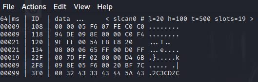

that's why I created this thread, to help get information out. Today I'm learning how to sniff the traffic the controller is throwing around:
The 2C3CDZC is the beginning of the vin, and the id of the controller throwining it around is 0x3e0, a few milliseconds later it will broadcast the rest of the vin. Right now I'm going to be setting up some brute forcing to see how you can get data with Caring Caribou (can utility). I'd like to see how to receive a PCM read and ultimately a write. I don't think any of these utilities exist right now on linux.

Small update, have been working on figuring out how to speak the correct language on the canbus, been doing a lot of research and found that the system uses ISO-TP. This means that if I send data to one arbitration ID (unique id) it will appear on another. This means I have to setup a sender and a listener. There are some good open source tools to do so namely isotpsend, isotpsniffer and isotprecv. All of them have quirks and nuances but make gathering intelligence easy. On top of the ISO-TP layers sits Unifited Diagnostic Services (UDS). UDS is to guarantee that any mechanic in the world can diagnose a car without paying stupid money to a higher conglomerate for proprietary data. These services are pretty well defined here: https://en.wikipedia.org/wiki/OBD-II_PIDs, andything above 0x10 is propriety but I have also enumerated those.
So when doing some enumeration I used the tools like follows (have to put it in a monofont):
to enumerate: echo "01 00" | isotpsend -p00 -s 7df -d 7e8 slcan0
response: slcan0 7E8 [8] [SF] ln: 6 data: 41 00 BF FE A8 93 30 - 'A.....0' - [???] Unknown
The bytes returned are hex encoded so that 1 means supported, 0 means not supported
1 0 1 1 1 1 1 1 1 1 1 1 1 1 1 0 1 0 1 0 1 0 0 0 1 0 0 1 0 0 1 1
Y N Y Y Y Y Y Y Y Y Y Y Y Y Y N Y N Y N Y N N N Y N N Y N N Y Y
1 2 3 4 5 6 7 8 9 A B C D E F 10 11 12 13 14 15 16 17 18 19 1a 1b 1c 1d 1e 1f 20
So of note you can request 01 20, 01 40, 01 60, 01 80, 01 A0 to find all the pids supported
all the way through 00 - C4, I would rather do this programatically.
to enumerate: echo "09 00" | isotpsend -p00 -s 7df -d 7e8 slcan0
response: slcan0 7E8 [8] [SF] ln: 6 data: 49 00 55 40 00 00 0C - 'I.U@...' - [???] Unknown
0 1 0 1 0 1 0 1 0 1 0 0 0 0 0 0 0 0 0 0 0 0 0 0 0 0 0 0 0 0 0 0
N Y N Y N Y N Y N Y N N N N N N N N N N N N N N N N N N N N N N
0x2 is the vin
0x4 is the calibration id
0x6 is the cvn (cali smog check bullshit)
0x8 is race stuff?
0xa is text name of ecm
Now for the proprietary stuff, anything above 0x10 is manufacturer defined and there are a few tools that can help with that Caring Caribou is a brute/sniffer of softs and it found the following:
└─$ ./cc.py uds discovery -ab 10
CARING CARIBOU v0.3
Loaded module 'uds'
Scanning for arbitration IDs to blacklist
0.0 seconds left, 1 found
Detected IDs: 0x122
Sending Diagnostic Session Control to 0x07df
Verifying potential response from 0x07df
Resending 0x7df... Success
Found diagnostics server listening at 0x07df, response at 0x07e8
Sending Diagnostic Session Control to 0x07e0
Verifying potential response from 0x07e0
Resending 0x7e0... Success
Found diagnostics server listening at 0x07e0, response at 0x07e8
Sending Diagnostic Session Control to 0x07ff
Identified diagnostics:
| CLIENT ID | SERVER ID |
| 0x000007df | 0x000007e8 |
| 0x000007e0 | 0x000007e8 |
then from there I did a follow on test
└─$ ./cc.py uds services -t 0.5 0x7df 0x7e8
CARING CARIBOU v0.3
Loaded module 'uds'
Probing service 0xff (255/255): found 7
Done!
Supported service 0x-2a: Unknown service
Supported service 0x00: Unknown service
Supported service 0x-2e: Unknown service
Supported service 0x10: DIAGNOSTIC_SESSION_CONTROL
Supported service 0x28: COMMUNICATION_CONTROL
Supported service 0x29: Unknown service
Supported service 0x3e: TESTER_PRESENT
┌──(weeeeeeeeee㉿kali-vm)-[~/canbus/caringcaribou/tool]
└─$ ./cc.py uds services 0x7e0 0x7e8
CARING CARIBOU v0.3
Loaded module 'uds'
Probing service 0xff (255/255): found 29
Done!
Supported service 0x11: ECU_RESET
Supported service 0x14: CLEAR_DIAGNOSTIC_INFORMATION
Supported service 0x17: Unknown service
Supported service 0x18: Unknown service
Supported service 0x1a: Unknown service
Supported service 0x21: Unknown service
Supported service 0x22: READ_DATA_BY_IDENTIFIER
Supported service 0x23: READ_MEMORY_BY_ADDRESS
Supported service 0x27: SECURITY_ACCESS
Supported service 0x2c: DYNAMICALLY_DEFINE_DATA_IDENTIFIER
Supported service 0x2e: WRITE_DATA_BY_IDENTIFIER
Supported service 0x30: Unknown service
Supported service 0x31: ROUTINE_CONTROL
Supported service 0x32: Unknown service
Supported service 0x33: Unknown service
Supported service 0x34: REQUEST_DOWNLOAD
Supported service 0x35: REQUEST_UPLOAD
Supported service 0x36: TRANSFER_DATA
Supported service 0x37: REQUEST_TRANSFER_EXIT
Supported service 0x3b: Unknown service
Supported service 0x3d: WRITE_MEMORY_BY_ADDRESS
Supported service 0x85: CONTROL_DTC_SETTING
Of course thought I am not expert and when in doubt I have to correlate my findings to what I can see with the MPVI2 which is kinda of cheating but hey, it's been fun over the last 48 hours and I learned how to speak ISOTP. There is more to come, I have to decide if I want to try and break the MPVI2 for use with Linux as it just uses a standard FTDI driver or continue using a generic connector like my Lawicel CANUSB and going from there.

I am building the software on top of SocketCAN which has built in drivers with the Linux Kernel, anyone that has this will be able to use the software. For greater adoption I'd love to use Windows but I dont' know much about it. Last time I did Windows development was 2002 and with the Win32 API.

Status update, wrote two utilities. One to query what pids are available on the system and anothe to read all DTC codes. These were exercises to get used to how the GPEC2A controller talks ISO-TP over can. Since it uses traditional sockets it was quite easy. Now these are using traditional OBD2 "words", should Stellantis have put in special codes/mmenoics/hidden fuckery I'll have to do the research to uncover them but so far comparing my work with HP Tuners I'm on par. Here is output from HP Tuners:

Here is output from my program:
Created can socket with descriptor: 3
Applied filter to receive responses from 0x7e8
Bound can socket to interface: can0 (index = 6)
Checking for stored DTC codes.
Encountered a First Frame, buffering data.
Sending Flow Control Frame
Found 18 DTCs
P0480
P0523
P0198
P0118
P0108
P2122
P2127
P0123
P0222
P1457
U0140
U11BC
P0103
P00FB
P012D
P2A0D
P1610
P1617
Checking for pending DTC codes.
Found 33 DTCs
U0101
U110C
P0480
U1110
U1120
P0523
U1403
U1411
U110E
U110F
P0198
P0118
P0108
P2122
P2127
P0123
P0222
P1457
U0140
U11BC
P018D
P0103
P00EB
P007D
P00A3
P0113
P0098
P00E1
P00FB
P012D
P2A0D
P1610
P1617
Checking for permanent DTC codes.
Found 8 DTCs
P0103
P0480
P0118
P1610
P1617
P0123
P0222
P2122
I plan on writing some more utilities and then moving into the UDS services that were discovered and potentially figuring out the seed key algorithm. I will make most of the code potentially open source however I probably won't make the seed key algorithm or how to read/write to the PCM public, maybe a snippe or a demo but not a full program. Don't want to seem selfish but those could be additional revenue streams for me.
