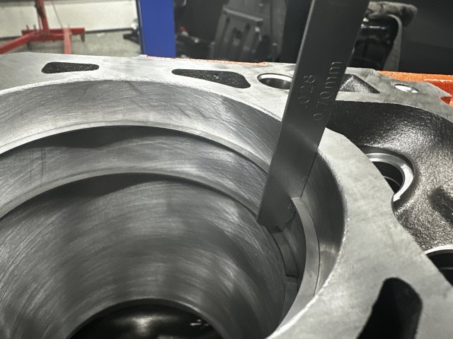

getting started. Rings are filed. .028.
block needed honed to fit pistons that are made for the bore. Funny how that works.
New block had a taper in the bores that needed fixed or would have had tight pistons.

Yes, a
Yes, this has been a finding on multiple new blocks (@fumanchu182)
8,775
7,697
Was is the same cylinders that had failures in the other block?
I did not ask what cylinders sorry.
This is a hellcat block can’t get a red eye one over the counter.

Really? Thats interesting
8,775
7,697
is there even a difference in the blocks besides color? Figured they’re all made on the same line and tooling

Just color is it.

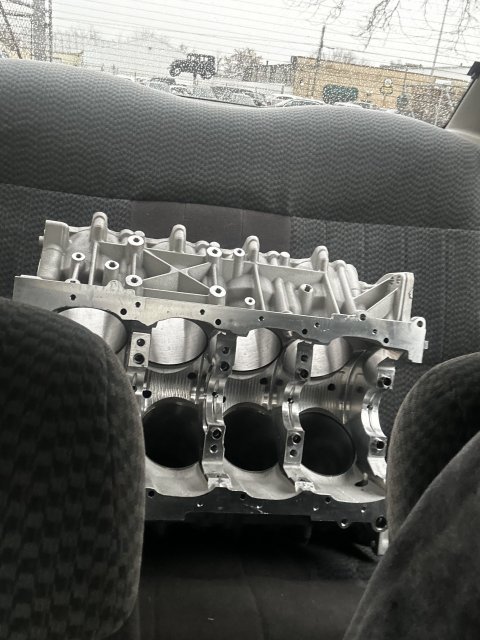

I have 6 blocks at the machine shop right now picked up 2 yesterday with my grand am.

I work in area where 50% of people don’t have insurance and in the last couple years don’t speak English. So beater with a heater

Interesting on the cylinders. Could explain some things.

Really wish we got the side by side piston comparison and if the machine shop knew which bored tapered
Waiting on a piston and rod assy to come after the holiday engine rush

I can’t believe the machine shop is that freaking quick you’re lucky out there I had a whipple manifold sitting at a place for 2 months and they didn’t touch it I went and took it back
I will ask tomorrow
my guy I dropped off two blocks Monday tone board and honed. 3 rotating assemblies and all done Thursday. He takes good care of me.
