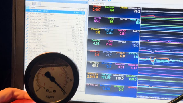

100% correct, my 22psi is like a candle burning brightest before it goes out.
Yeah my boost from a 2.4 is just a fart in the breeze compared to the same boost from a whipple
Well my son will tell you 29 lbs from the 3.8 is pretty freaking scary lol Especially with a laptop on your lap, a gauge in one hand, phone in another taking a video and just hearing hell unleashed around you pinned to the seat. My seat belt didn’t want to let me go even, had to unlatch it for it to release me lol

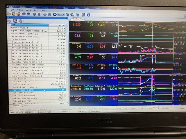

So far 2 295’s on the KB BAP are keeping up, injector DC has not hit 70% yet, Fuel pressure staying above 75 psi setpoint to where pump DC has yet to reach 80% even. Full pulls 1-2-3-4 to 150 mph last night netted the same.

From your log running close to 30psi on the 3.8 is wild compared to my barley 20psi on a 3.0. What is the altitude and DA where you are? I am trying to figure out how you're not maxing them out and I am.

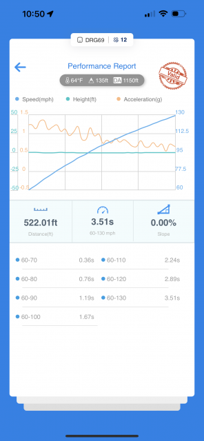

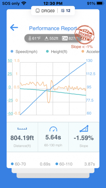

Did a 60-130 pull last night, traction SUCKED, had to leave my underwear by the side of the road after the run lol
Yes, a bit of a down hill slope but only 8-10 degrees of max timing commanded and traction control took it away as fast as it dialed back in
DA and temp on top. Not my best run but based on cold road traction it’s all I was getting lol
