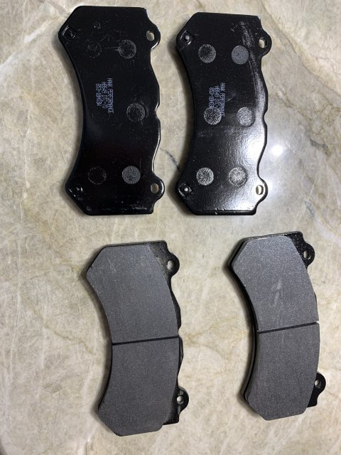

Those Brembo pads had a half day remaining. They suck, they were worn crooked also, we have seen that before.
Speedlogix has a good line on the product, so she was able to help me overnight. The debris on the front wheels after I scraped the Brembo shit and bedded the Hawk was amazing. The rears could give a rip.
Front
Rear

DGatzby, in your experience (and given that I have none) how much remaining brake pad is safe before a two day HPDE weekend?
A new set, and a spare set. This road race stuff is not easy on the pocket.
Front
Rear
Okay...alrighty then...sounds like I'll need a mobile garage. I know 10/10th's Motorsports has some verbiage about "enthusiasts helping other enthusiasts" (words to that effect). I saw a tire vendor at NCM's track last year. I'll check and see if there is somebody changing brake pads for a reasonable fee.
I won't plan on ever buying OEM brake pads.

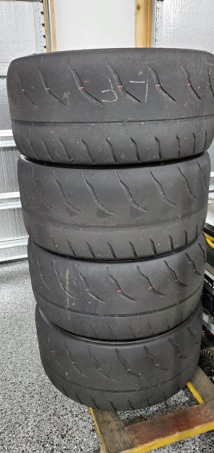

Here are my tires after 5 track days and less than 1000 street miles if memory serves correctly. From top to bottom
Driver Front
Driver Rear
Passenger Front
Passenger Rear
My Driver Rear is the most heavily worn which makes sense in that most corners on CW tracks will be right turns and I'm usually pretty aggressive at coming out of corners. The other 3 tires are wearing pretty similarly and probably had 1 more track day in them. My Driver Rear was starting to delaminate.
These are 305/35 R888R on all 4s with 10.5 front and 11 rear wheels. MP springs with a Hotchkis front bar.
