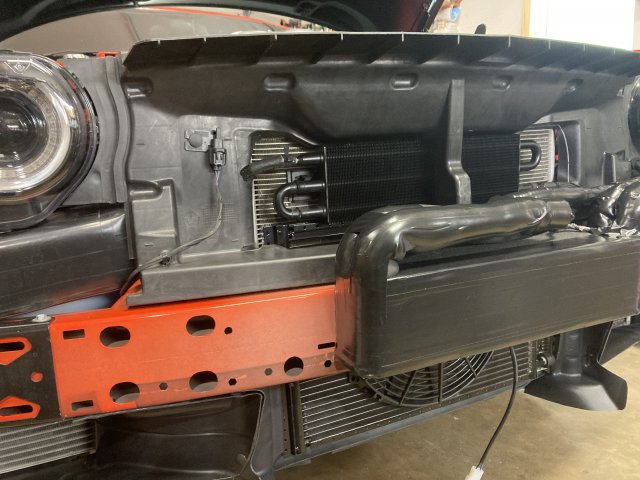

I didn’t realize you moved yours to the front of the bumper

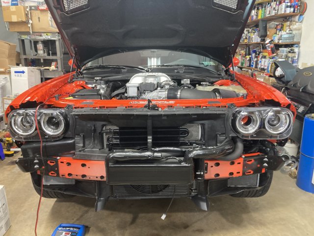

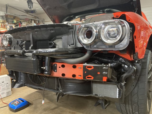

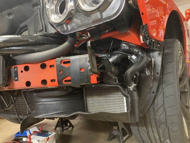

The FI HX was too big to go under the headlight where the KC unit was, had no choice. The FI unit is twice the size of the KC unit. The 140 oz hopper tank is still under the passenger side headlight. I can have those made too if anyone is interested but their pretty expensive anymore, labor and materials have gone up 25-30% in the last 4 years, wonder why 🤔

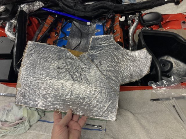

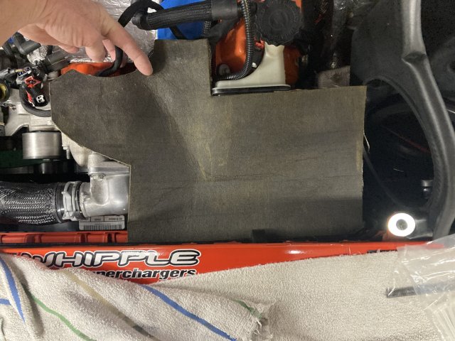

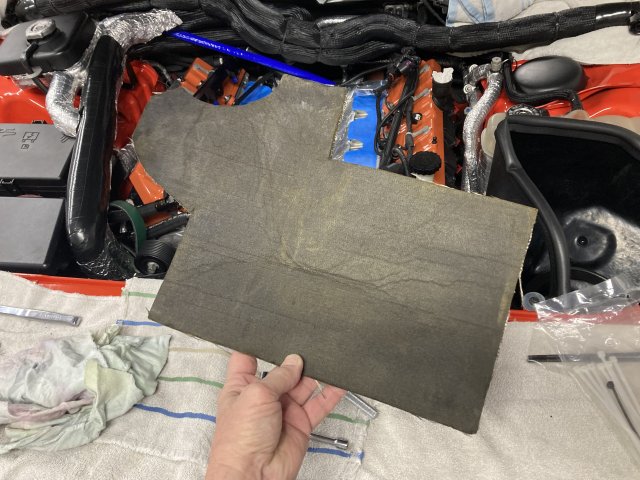

The Pyrol shield under the intake tube and TB helps keep IAT down allot, an amazing amount. This thing. I have snout 10 of them left if anyone wants one of the last ones I’ll ever have let me know.

Are you still using the air box with the intake, or did you have to remove it for the FI refrigerant lines?

@16GoManGoHC2 thanks for offer on heat shield. My intake air pipe is almost straight down now off the TB so I’m not sure if it’ll fit naturally?
But that’s a good thought, maybe I need to consider heat wrapping my air intake pipe.

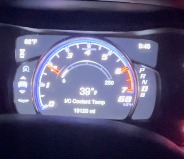

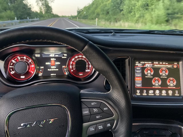

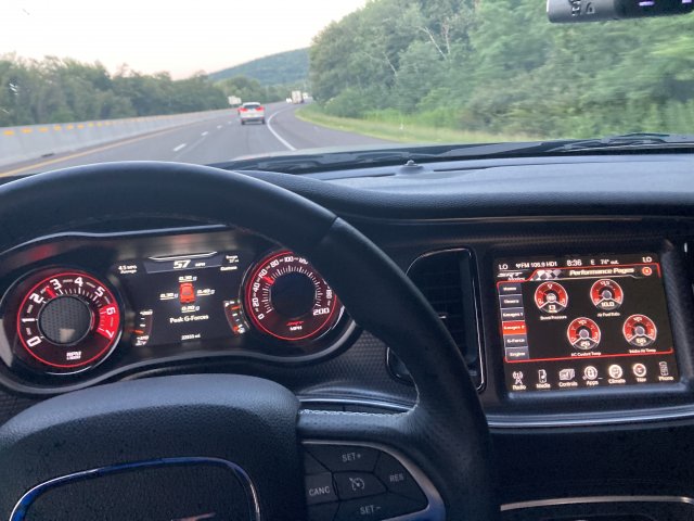

These were the best I got last night.
Ambient 70F
One is during highway cruise, other right after stopping from the highway off ramp. Speeds are displayed below RPM-7. Top left is the IAT. I was cruising highway at that speed for 20 minutes before I finally made it down to 33 I/C coolant. Drag valve on entire time.
city cruising even with drag valve IAT 40 over ambient and I/C coolant best is down to 40F range. Without drag valve, add about 5F to IATs and 15F to I/C coolant.

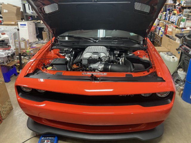

No, Whipple air box and intake tube from head light still fit. Can’t really even tell there’s a chiller hiding under there. See filter and air box in there?
Ambient 70F

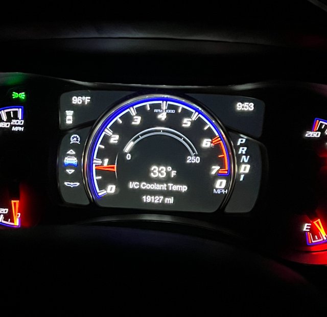

Mine gets to under 32F within 2 miles of driving. Recovers from a 1-2-3-4 0-150 pull in about 2 miles as well to under 32.

BTW, an intake pipe heat shield will help keep IAT down and take some heat away from the intake charge so the chiller won’t have to, ie possible even lower temps. I have a few left if you want one let me know, once this material is gone there will be no more. Reflective side goes down, black side up, keeps radiator heat off the intake tube and bottom of TB.
