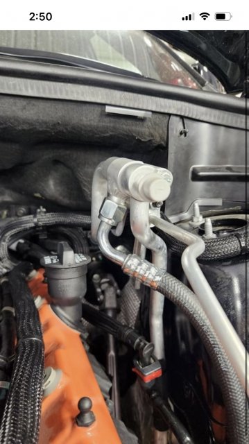

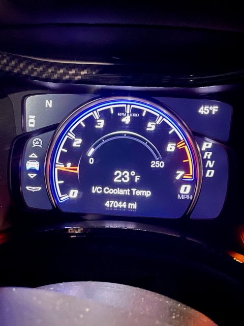

Took delivery of my Trackhawk last night.
Active Interchiller seems to be working. No leaks. But more questions than answers.
Vehicle came back with a handful of new parts, namely compound boost set-up (hellion TT). The IATs and I/Cs are not as cold as some of the ranges I've seen from other vendors. I'm not sure if what I've seen is apples to oranges due to being different kit's and/or my set-up set-up produces a little more heat due to compound boost? Freon used to recharge 1234y. Tuner mentioned the kits components and materials used are all fairly similar, so results tend to be similar, just the execution and kit contents can differ (i.e. how PnP one is relative to another).
This is what I got yesterday evening on following variables (am I missing other influencing variables?)
E25 (had to top off with 93), ambient 74F, boost controller at base/default = roughly 15 PSI total boost
Best readings (comp switch on = all freon diverted to chiller)
I/c coolant 45F
IAT 115F (city @ 30 mph) and 100F (Highway @ 70 mph))
Middle readings (comp switch off, freon shared between cabin and chiller = cold air condition in cabin)
I/C coolant 60F
IAT 120F (not much diff from highway to city speeds)
Worst (AC off --> 3-way bypass should be shunting fluid toward the oem heat exchanger)
I/C coolant 102F
IAT 129F… this value may be a ceiling value? Tuner re-programmed the BCM such that the outside temperature on dash screen reads the IAT (and the IAT now reads ethanol content). The IAT as displayed as outside temp never went above 129F. However, pre-interchiller last summer, I have screen shots that include Ambient 81F -- I/C coolant of 109F and IAT 145F (city cruising)
So taken together...
• Stock = I/C coolant 30F over ambient .. IATs 65F over ambient.
• Active interchiller = I/C coolant avg. 15F below ambient (net -45F) and IATs 45 over ambient (net -20F)
From other chillers, they don't usually post as much context.. but I see people/mfgr's claiming I/C coolant's as far as 40F below ambient and IATs 10F above ambient.
Assuming my 3 way valve is correctly plumber and programmed (that my post-chiller fluid is actually bypassing the HX when the AC is on).. any thoughts?
• Not 100% sure where my IAT sensor is pulling the air temp from now that I don't have a CAI.
• If IAT is measuring pre I/C bricks, then does the IAT really matter?
• Do the temperature values become arbitrary past certain cooled temp i.e. as long as the temps are cold enough to prevent the tune from pulling timing then the chiller is doing its job?

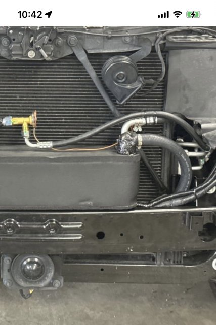

Thank you for your input and pictures, is the stock Intercooler and Chiller providing cooling for 2 turbos also? Once instructions are followed with the provided insulation and Active HX Bypass programming optimised you will lower Intercooler fluid temp. I would look into a bigger pump for compound boost since you have a 70* Delta. You also might want to upgrade to our Stage 2 Interchiller, you should look at our Stage 2 Upgrade while it is on sale.
As you can see in your picture insulation is missing, and the HOT AC hose needs to be moved from the Cold AC hose. It is normal when a soft aluminum AC fitting arrives bent to straighten it out also when a fitting needs to be rotated to rotate it. I discussed this with your shop and they agreed with me but had reservations about doing this while working with you. I offered to express a new hose and fitting but never heard back from them. The exclusive adapter pictured on the suction line under the hood provides no cut installation while keeping the hose out of the way and close to the OEM line.
Oh, where is your HX Bypass Valve installed? Any pictures you can send us would be much appreciated. You have the highest quality 100% bolt-on Interchiller Kit with Active HX Bypass available and at the lowest price!

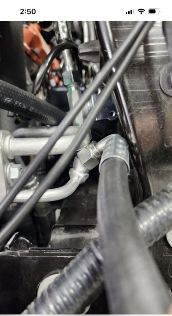

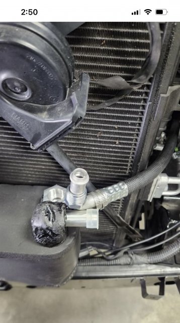

Hey all. Longtime reader of the forum..
Shop is installing this kit on my trackhawk, this is the one made by Dave Spurlock. Shop has run into the following issue, pictures attached.
The fittings on at least two of the hoses won’t articulate with the hardware they’re intended for due to the directions/angles of respective connection points.
Mr Spurlock recommended we use a vice to bend the fitting to get it to articulate with the port coming off the chiller.
Anyone installed this kit before, did you run into this and were you able to bend the fittings?
View attachment 139654 View attachment 139655
I have AI Chiller on my 2017 HC. I installed & recharged system myself and had no issues as you had. It works great.
