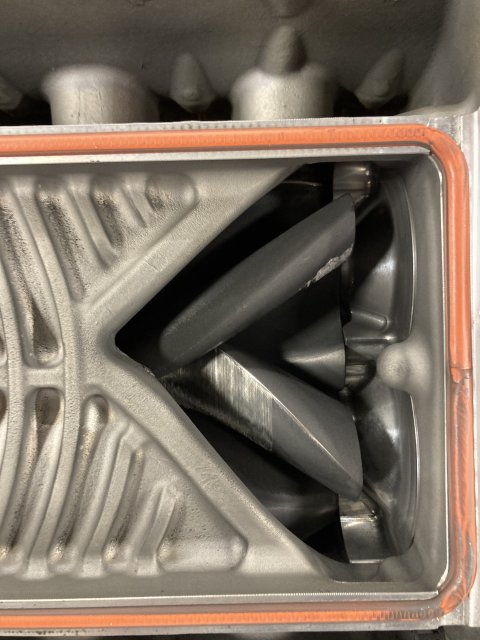

Check the rotors. Two easy ways to do that. Pull the lid to see the rear or pull the throttle body to check the front (easiest). The original billet version in the first picture. It’s got 30 passes plus dyno time on it now and makes a ton of power. Over 1400whp at 3000’ elevation thru a T400. It’s still in perfect condition. The second picture is thru the front of another that started eating itself. We’ve found that they don’t like rpm. Anything smaller than a 3.50 pulley is a problem. Stay tuned. It’s a saga. 😂 View attachment 132919 View attachment 132920
Mine’s a billet one as well, no rotor wear last time I checked but I think I’ll take another look.

Yes. We only use the +10 balancers.
My last Gen 6 3.8 lasted less then 100 miles, 3-4 street pulls and 3 4th gear dyno pulls and the rotors ate each other and the housing this time too!!
+10 ATI lower and 3.50 Satera CLUTCHED UPPER PULLEY and it still failed!! Dusted my engine so bad with aluminum dust the oil sample analysis drawn with oil the that only had 100 miles on it as well picked up the aluminum in the oil!!
View attachment 132944 View attachment 132945 View attachment 132946
Id have burnt HQ to the ground after that.
That’s when I threw in the towel with Whipple, I sold the warranty replacement while it was still new in the box.

Every generation has had an issue btw. They continue to improve but countless ppl have had zero issues with gen 5's. Maybe some are just built better idn.
I think tune plays a roll sometimes but not always. Once them rotors become unstable they become unhappy quick. Ive seen a few friends with 3.0 whipple gen 5's making BIG power and never having an issue ever. I have a 3.8 so I guess we will see how long it lives this year lol
Not sure why they just dont offer billet rotors for the new generation models. Especislly for the 3.8 since its gonna be making quite a bit more power than the 3.0.
It really sux there is only ONE player in this entire league! So rediculous I have to chose Whipple or chose nothing smh such a joke. Like where is Magnuson? Where is VMP for this platform? Edlebrock? Its such a huge market I just cant wrap my head around why there is ONE blower to choose from so frustrating.
They don’t play because they’re all using the same Eaton 2650 roots pack, right? The only twin screws have been Whipple and Kenne Bell. Doesn’t KB have something? You could always ask 007.

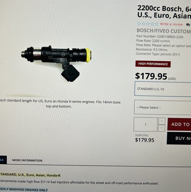

I'm beginning to wonder myself if I would rather pay for the fuel system or the cost of fuel. Either way they have you by the balls.
The injectors alone are more than double what my dual pump system cost originally. Oof.

Will need at least 2150's, triple pumps, and 2 baps.
