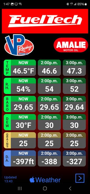

I'm impressed considering the track conditions and the weather. Baro is low and the DA is negative 397 or so.

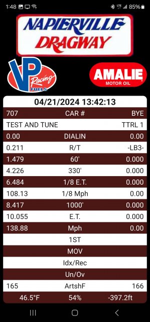

So I drop the pressures in the rear to 19.5 and leave at 1600-1700 rpm or so. Which is what I do when traction is an issue. The board shows 1.47 60' then 6.48 in the 1/8. Hmm this is going to be a decent pass as my other 1/8 times were 6.5x-6.6x.
I get back and check the app.
10.055@138.88. Holy c--p a new pb and the previous best of 10.064 was in neg 1200to negative 1300 da with baro around 30.1.
Normally with better track and da the0' times are 1.45 -1.46. So there is room for improvement.
Sorry for the long post. LOL
Screenshot_20240421_134801_Racing Slips.jpg Screenshot_20240421_134752_Racing Slips.jpg

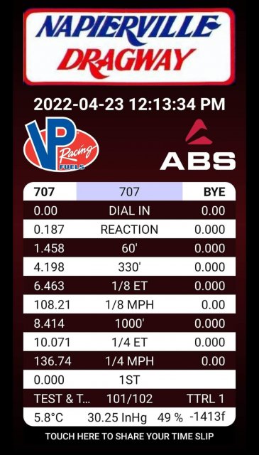

Jack I just got a FB memory from today's date in 2023. Check the baro and DA at the bottom. LOL
I think that was the same tune without the extra 200 rpm. Screenshot_20240423_161643_Facebook.jpg
