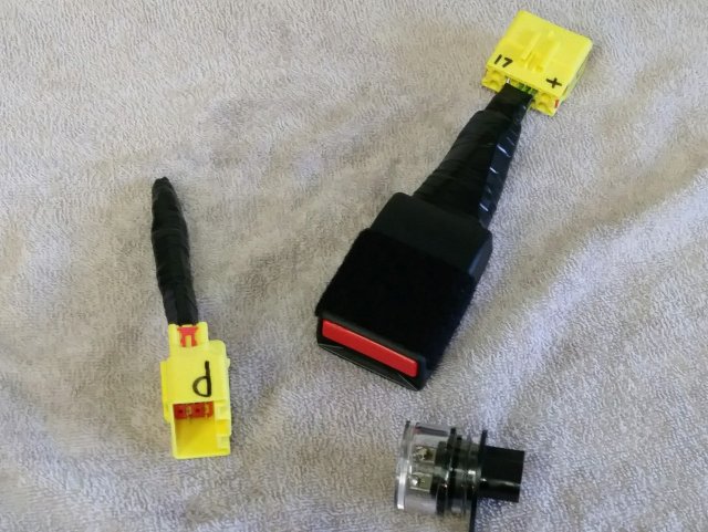

I took the info that Pete posted in the other forum and info I learned from members buying full on Hellcat Harnesses for me to cut apart and learn from, and now I can now make bypass harnesses for 2015 - 2019 both Pass and Drivers side. I am now making them with all resistors. No seat belt buckle needed anymore. So, they are cheaper to build and more compact. I also make the Windshield Washer Bottle level foolers if someone wants one of those. All this does is make the AirBag light in the dash go out. So, if you are like me and do not like warning lights on. The main reason I got involved in this is because you may not pass Tech at some tracks with your AirBag light on and my Friends and Forum Members were asking me to make them. My local track, Irwindale, will not let you race with the AirBag light on.

Right now I am paying $44 plus shipping just for the harness to cut apart. Literally just to get that yellow connector and 8 pins with 4" of wire. I do have a slightly cheaper alternative ordered but do not have them yet or even know if they will work. Surprisingly I looked under the seat of my 2018 Ram and it uses the same connector. Or not surprisingly. So I have those ordered. And I can order $1.49 of resistors and it costs $8 to ship. So, after about 3 go rounds I ordered a bunch all at once.
So the price may change someday. Right now I want $125 shipped USPS Priority mail flat rate small box. $175-$185 with the redundant seat belt buckle, for the drivers side.
So the price may change someday. Right now I want $125 shipped USPS Priority mail flat rate small box. They were $175 with the redundant seat belt buckle, then I figured out a work around with resistors that cost a few cents VS $50.

I only said it will turn off the airbag light. But if you want the seat belt light to remain off then it will require a redundant seat belt buckle that would add substantial cost or the harnesses can be made so you can unbolt your OEM buckle off your seat and use that for no extra charge.
This is the redundant buckle version. I am pretty sure you would have to plug in a clasp into the drivers side to eliminate the seat belt light. They can be bought on E-Bay to eliminate the chime.... RITTER.jpg s-l640.jpg

Most Guys want the redundant buckle. For convinience if switching back and forth. Also it's lighter the way I make it and can be hidden easier. either verson will not have the seat belt light on, on a 17 Hellcat Pass side only. Pm me when you are ready. I have some parts in stock right now. Otherwise I would have to order them from a Dodge Dealer (mail order so it take 2 weeks on average).

srtdusty has been very helpful with feedback and testing these. So, what we discovered is that I am able to fool the Pass side with all resistors. No buckle needed. The car is happy with resistors where the buckle is. So with the Pass only all resistors you will not have an airbag light and you will not have a seat belt light once you buckle the drivers side seat belt. BUT : I have not and probably never will be able to fool the drivers side seat belt. Because there is a difference in what the car wants. For the passenger side the bypass is making the car think there is an unoccupied seat and can be fooled with resistors. For the drivers side the car wants to see a "buckled seat belt". The difference is the drivers side does NOT have an occupancy sensor. A person present in the drivers seat is assumed. Duh! The buckle has a Hall Effect sensor and it cannot be fooled with resistors. As far as I know the Module in the car applies a voltage on the buckle circut and is looking for feedback of some sort. Also polarity on the actual buckle circut does matter. So, another thing that can go wrong.
