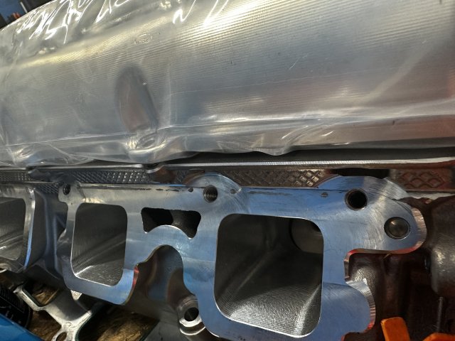

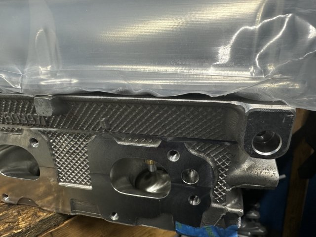

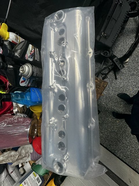

Manton new valve covers fit like a glove.

use factory gaskets ready to bolt on. Can’t ask for a better product for the price.
don’t buy the copies buy the original

Pretty sure I think we discussed this. Mine fit no problem, little tight on install but after that easy day.

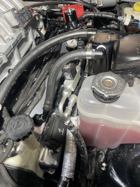

Semi buttoned up. New an lines on driver side. Spent 48 hours thrashing, wouldn't have it any other way. Time for bed, gonna do the coolant side during the week.

I had to modify my new Cornerstone covers to work with the power steering. I haven't seen any kits to eliminate the power steering on a hellcat yet.
Robert, What portion specifically had to be modified? I have the Cornerstone covers but no plans to have HHP install them until the new block is finalized.
Any pics of what had to be changed?
the front edge needs to be milled down pretty significantly. I've got the 6.1 pump and remote reservoir ordered.
