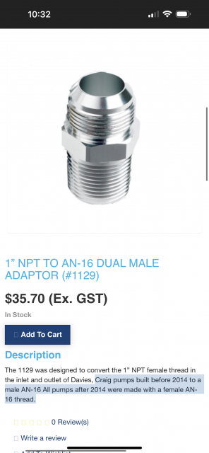

Ok, this is interesting

So they just use a regular 16an and paste the crap out of it? Idk about all that..

Clear a mud. Everything says it takes a 16 an orb, yet Davies Craig’s site says you can use this regular fitting to convert the pump from 16 an to 1” npt 🤔 and the pump doesn’t have a flare inside, not sure how that’s supposed to seal at all

The way I read that is all the pumps after 2014 are AN. That means your fitting from the tank will be male NPT into the tank with a male AN into the pump. Pump out will -16 AN in and out. Done👊
Man I hope so, but summit specifically says it’s an ORB fitting 🤦‍♂️
