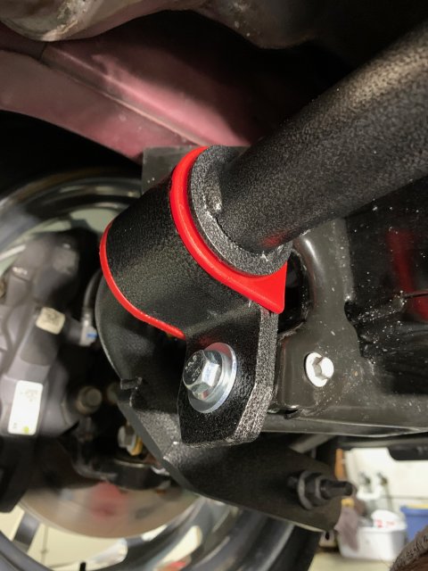

Ref. BMR adjustable 38mm sway bar. Good product maybe, but is missing some simple replacement hardware for us.
First the BMR saddle assemblies VS OE saddle bolts. Not enough washer bearing surface area!!
First they are metric spec 10.9. Second and most important I will be buying new boots with LARGER washers today (yes I know to also get the correct specified washers to go with the bolts). The little tiny small washers locked onto the stock bolts supplied by FCA went through at least one of the large slots made on the new saddle assemblies, when attempting to just get 44 ft-lb torque. That pissed me right off! IMO opinion all four bolts need replaced, and should be included with the product. No way I want to worry about not enough bearing surface holding my front sway bar to this huge thing while turning it to its max capabilities! Would that be a fun day at the track as you basically pull your sway bar loose from the structure?
Also what is missing from the product is another set of thermal barriers like the OE covering the bushing saddle protecting it from the heat radiated off the converters. With the larger saddle assemblies, the OE barrier/protectors won't come close to fitting back. I imagine the heat radiating from those converters are just going to bake the great silicone grease I used. Again, not a good thing to worry about and probably a new necessary at least annual inspection and maintaince item.:mad::mad::mad:

After purchasing new metric spec bolts, that are 1/4" longer, I simply added some nice fender washers to get bearing across the large slots they provide for the brackets.

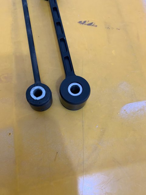

Anyone who thinks those OE rear links are even up to a fraction of what we throw at them, look at this difference btw an Energy Suspension bushing and whatever they call the units that came on my $91k car! After just over 3000 miles they were already showing signs of permanent deformation at the cheap little pieces of rubber. Never mind that the new steel barrels were made in someone's garage and sold to us for over $200! It will work. I cleaned them up along with the trailing arm barrels as best I could. My guess is they need to be a bit longer, but I'll sandwich them in spacers and watch what happens.
Another thing I did was take a bolt and wiggled the bushing that is in the OE trailing arm! Wow, wiggles like it has little or no resistance to deflection! A guy can just imagine wheel hop in action as they spring from compression on acceleration.

My post #7 above compares the very small bushing on the rear sway bar link to a common aftermarket replacement. Same post that giant red unit is the upgraded front sway bar connection bushing. It don’t even fit within the OE slot the stocker is mounted in.

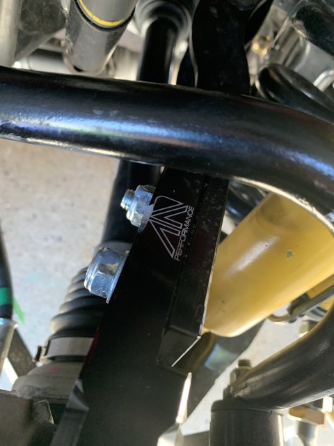

Continuing the discussion. Yesterday I changed the camber on all four corners with the AAD hardware. The front worked smooth and easy, the Allen Head tops are two metric sizes, as are the underside nuts. For the camber I used the next tab for more negative. All six arms; four in the back and the two in the front actually all contain the same tab for their street setting, which is very convenient. The fronts use the tabs going one direction and the rears the other direction. Again convenient, since I have a collection of about all their sizes.
The rear was a bit more messy to screw with. First I am glad I did not wait until Saturday morning. I had a damn flashback of working on custom bikes!

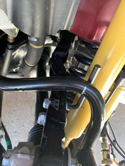

1. A regular key/wrench has a problem both itself or if a guy has a longer reach variety of some sort. The shock is in the way, of any straight shot.
Little work with a saw, and now I have another custom tool in my collection..

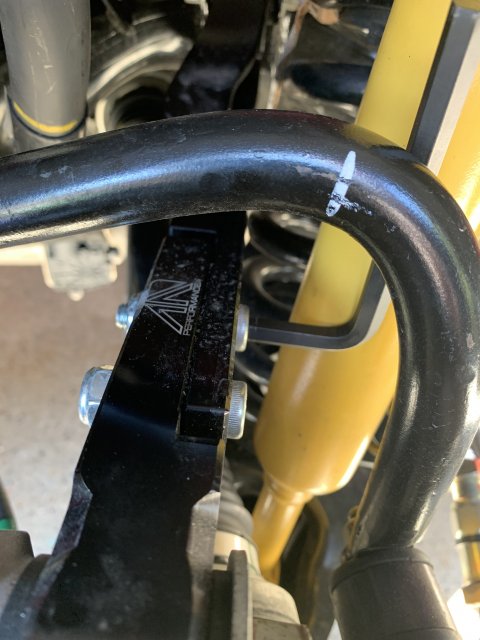

See the other little problem with mixing aftermarket parts??
Solid sway bar links that bring the sway bar so low it contacts the arms. That pisses me off because it will be smashed worse after Saturday. Now is that inhibiting some movement of one arm and causing a misalignment at full compression?? Probably!!
