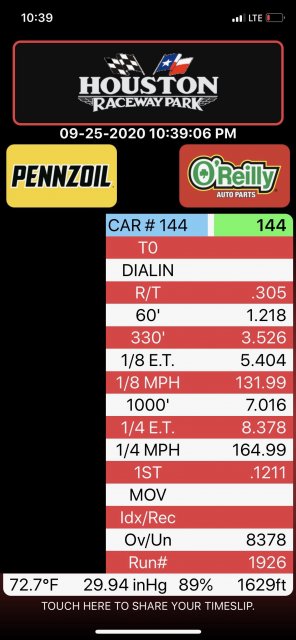

Here’s my slip, reset my PB in every category pretty much including a scorching 1.21 60’.

132 in the 1/8th, that’s hauling. Nice run

Damn! The pieces of the puzzle you’ve put together to accomplish this is amazing. Looks like the conditions can be a lot better too. 75 degrees? When some of that mineshaft air comes rolling in there... 170mph? I know we’ve had big plans going forward with mine and we keep looking at what you are doing and are going..... did you see that!!! Anyway... huge congrats. Really looking forward to seeing you crack the 7’s. You know you’re going to do it!

Your 1/8 MPH is faster them most people's 1/4 MPH

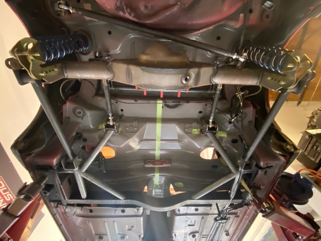

This will get you a 1.1 sixty. That's how I'm gonna do it! 200 lb weight savings plus much harder launch capabilities!! IMG_0483.JPG

I'll pass, lol. Biggest event of the year around here is TX2K and their street car and heavy weight classes require stock location suspension. Plus, I think it's pretty cool how I have my car setup doing what it's doing on the factory IRS. I'm going to keep at it.

Yeah, you are probably getting that 60’ done in world record time for a IRS. Certainly for a heavyweight. I’ve never heard of anybody else having done anything close. This stuff being a hobby.... I need to keep doing stuff to entertain myself. We can never stay in one place for long. I don’t want to run nitrous on mine, so I’m pretty much stuck with my power level until the unicorn supercharger shows up. My biggest race is MATS Las Vegas and at least so far I’m not restricted in the class I would run. If I travel to run MSHS, I’m pretty much a 8.5 Super Pro or HW and neither of those classes are restricted as far as mods go. Both of our race seasons are at hand and the guys up north are going to have that short shot at good air before storage. I’m betting we start seeing the record times getting a lot faster soon.

That picture really puts things in perspective LOL Congrats again!
For the record you have not broken a single OEM diff this season? -no need to change the factory IRS if everything's working perfect. As the old saying goes if it ain't broke don't fix it.

I have not broken a single OEM diff in my 4 years of owning and racing this car. I have however swapped to fresh units over the years for various reasons like I wanted to try 3.09 early on and then I went back to 2.62 for a while, swapped out to a fresh 2.62 when I thought I had diff issues (it turned out to be a bad axle), and now I have a fresh 3.09 in there.
