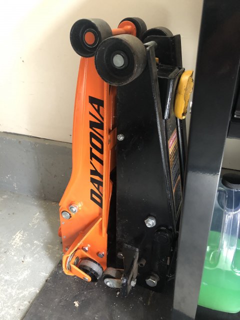

Will storing hydraulic floor jacks vertically cause them to leak?
2,672
7,354
Something like this:

I'm not sure. I've always left mine horizontal

Shouldn't?
2,672
7,354
I snugged down the valve and they seem ok. Ill check them when I get home.

The only problem with doing that, is that the jack mechanism has a vent on the oil reservoir. either in the fill plug or elsewhere. And when turned up end wise. It can leak oil out of the vent hole. Just like anything else that has oil in it. it is made to function in a certain orientation.

Just checked them for leakage, so far so good.

Pit Pal Products makes a floor jack holder that mounts to the walls of trailers to hold jacks in that position.

I’ve stored jacks vertically long term with no issues but was opposite direction, large wheels down, pump up
