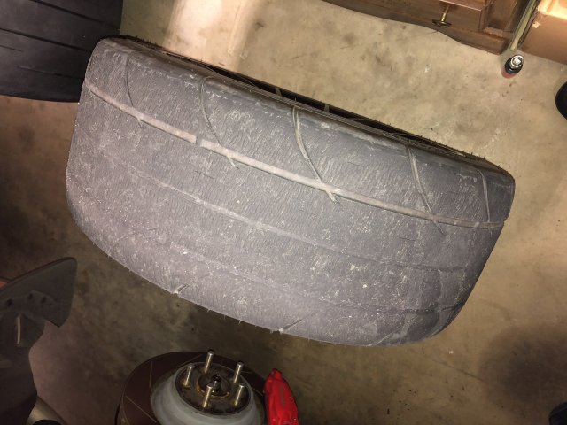

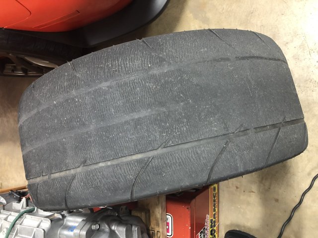

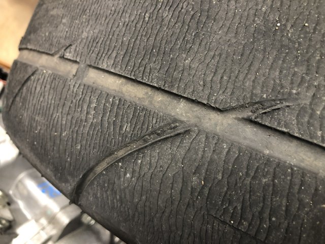

Not looking for a war of tires here just sharing my experience with the ET SS’s Here’s my MT Street SS ET’s
They didn’t last 3 weeks I don’t think, hooked up decent for maybe 10 runs and they got worse and worse and I until I replaced them. I may try a 555RII but I’ll never use a Street SS ET again. I love my 315 NT05r’s on the street, they grip god right till the treads gone. M6 here and I’ve done 11.3 136 mph on the street 1/4’s with them and 3.2 0-60’s. Now at the track I run a 17” 315 MT Street R and love them at track, best 10.6 at 136 mph with 1.51 60’ and that was the first time out with them this year and then thy closed the tracks the weekend after. I’m not brand loyal to nothing except which worked best for me, at least. Maybe I just got a bad set of the MT Street ET’s? They did nothing but ball up with snots which was like launching on marbles, see picture. But they where trying to harness 850 wheel too, that’s a tough match for any 20” tire lol.

I read it as the NT555RII was designed to be an improvement over the NT05R so much so that sidewall construction was modified to provide better 60' times over the NT05R with the NT05R having a slightly more aggressive design.
Still a weird way to put it, they must be pretty close to one another is the way I’ll take it lol. My guess is the NT555RII is a full tread depth tire not like the 5/32” depth when new NT05R s are like. I’ve been told my tires are bald and need replacing when their brand new lol. I may try the 555RII’s some day.

those wheels shown in the pic above, those tires are out of balance. One side has tread and the other doesn’t. Those tires are trashed.

You can also see in your pic that you have destroyed the tire. The ridges in the rubber is the multiple heat cycles of melting that rubber apart and then it cooling down. I’ve done the same thing to my first sets.
I only see that type of damage to the tires noawadays after a dyno session and we have wheel spin on the dyno. Never on the street, unless the tires have been bbq’d
one of the reasons your having traction problems is because your rear end is not balanced right and you don’t have a good contact patch.
some adjustable or fixed position rear control arms will straighten that wheel and tire out giving you a solid surface.
It will make that tire last twice as long and you will get more traction which will reduce all that wheel spin your getting. Making everything better. You can’t simply blame those things on the tire. If your killing a set of MT SS in 700-1000 miles it’s not the tire.
