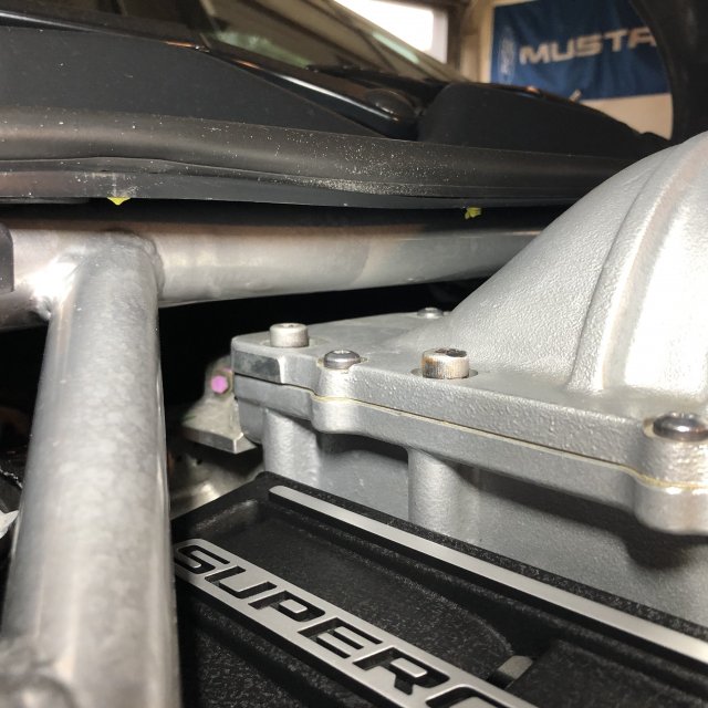

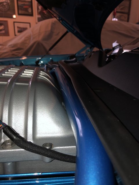

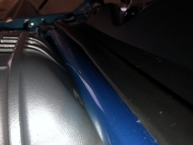

It might depend on what brace ?... but my Speedlogix 4 point strut tower brace fits with FI spacers still with 1/2" gap.
Better picture of that gap please?
5,189
9,649
OK @BULL , just for you , added pics to my previous post.

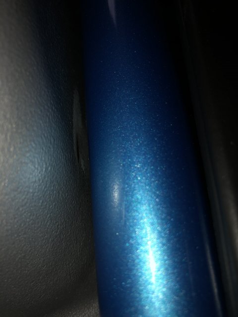

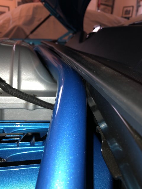

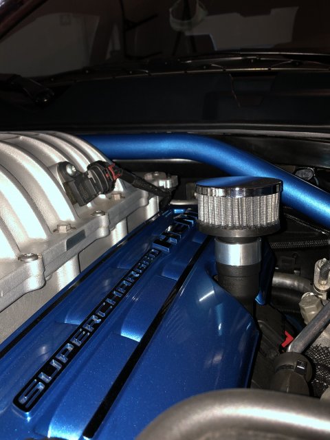

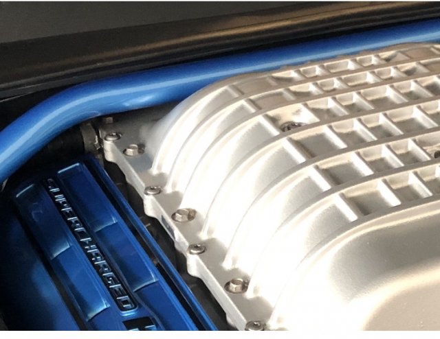

@Old Mopar Guy can you post some pics like Mean Cat did please? Pretty please? Showing the close up...
2,568
7,074
Since you asked so nicely Felt. Here you are:
7DF04377-CA48-4381-84B5-C73BEDB6C086.jpeg F72065D1-479E-452C-B509-B013581F02B5.jpeg 556533BE-0373-45C8-947A-35BB36B44261.jpeg 21D298F3-78D3-46BC-9A6F-18D71E198AAE.jpeg 87820B00-9461-4231-92D3-FD6F7ACDC3D2.jpeg 12605B36-C059-42C1-BABC-A0156810A5E8.jpeg
2,568
7,074
Not much wiggle room at all. Initially I might have gone with the SL brace, but Ive heard more bad stories than good about their CS, and they didn’t even offer it, or the rear, in B5.

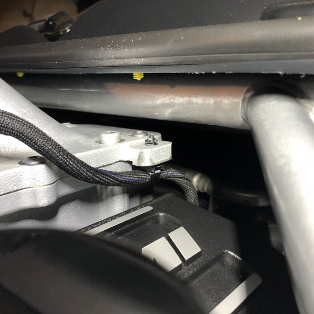

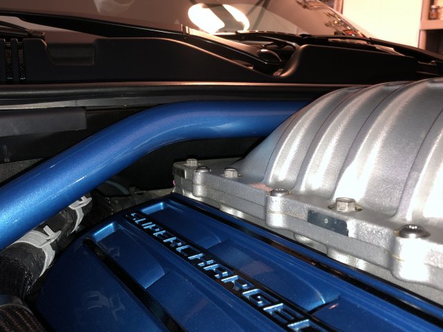

Thanks man I appreciate that! I'm not anywhere near my car but I have the Petty brace and the FI spacers sitting at home....hmmm...might have to to rethink all this now. That looks like it might not fit. I guess I'll have to wait and find out.
2,568
7,074
Love the Petty brace but there is no way the FI kit is going to fit. Im having my doubts about the other kit above as well. My bar almost touches the sc dome in the rear as well as that oem bar.
Felt
#1004
113
150
Philadelphia
2019 Redeye Challenger
I agree...from the 1st pic it looks like there's a chance but that dome pic looks like it won't. AGGGHHHH back to the drawing board.
