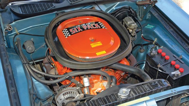

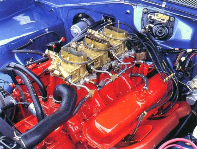

https://www.swinger340specials.ca/340-review
340 gets Six-Pak (AAR Cuda & T/A Challengers only), T/A blocks had thicker webs for the ability to install 4 bolt mains
• The 360 J-head saw first limited use in the 1970 340 Six-Pack AAR/TA, which had 2.02/1.60 machined heads and revised pushrod holes for more meat in the intake runners (915’s)
• Engines were painted orange
• A Carter AVS Carburetor (3 Holly Caburetors on the Six-Pak set up)

Did the six paks have a different cam?
Markp
#968
5,219
27,251
Fuck Trudeau
Also 340 six paks had the Edelbrock aluminum intake manifold
Bkuz
Bkuz
#1065
1,850
4,329
Brooksville
A mild hydraulic flat-tappet cam from Sealed Power (part No. LS644) with 0.429-/0.442-inch lift, 201-/ 220-degrees duration and 114 degree LSA matches the cam used in 340s mated to the Torqueflite automatic transmission. Four-speed 340s got a slightly hotter cam in 1968 (only) with 0.445-/0.455-inch lift and a few more degrees of overlap. Stock-spec hydraulic lifters are also from Sealed Power (part No. HT211B). The 1970 340 Six Pack used the same Torqueflite-spec cam used in all other 340s that year.
