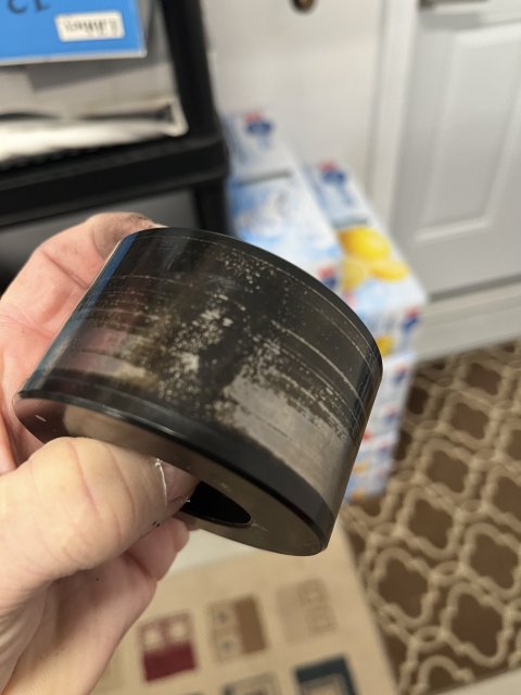

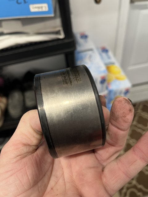

So I decided to replace the tensioner and idler pulley with the Metco product as I did notice that although the bearings seemed ok it was visibly obvious that the belt had been slipping on the pulley as seen by the pictures below.

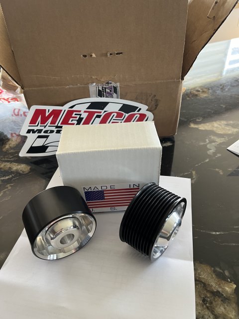

The Metco pulleys not only looked a lot nicer they were considerably lighter. IMG_7974.jpeg

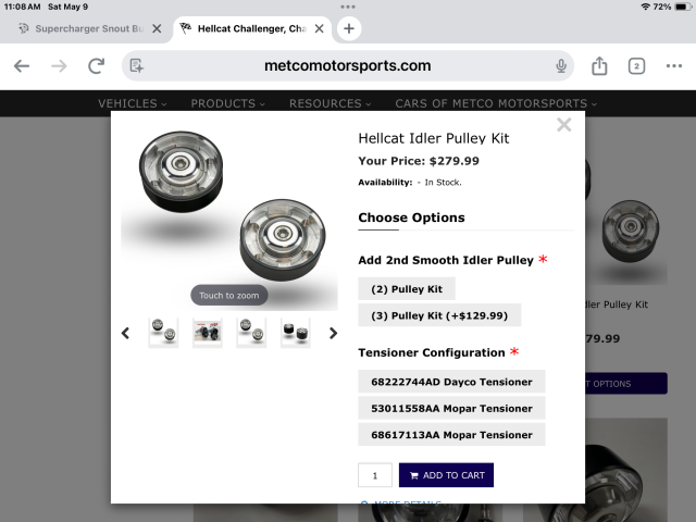

IMG_8594.png Apparently they used 3 different tensioners on these cars so you have to check and see which one was used on your particular vehicle.
On my car they used the Dayco tensioner, I am not sure what is actually different between the three.
