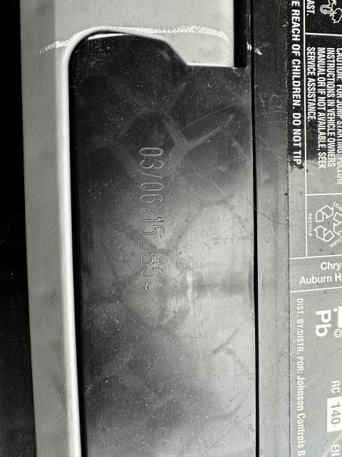

Welp, sad to say it… but my original 2015 factory battery finally ate it. Charger says it’s fully charged, won’t start car. It’s been a good run.
What are the good replacement options? I’d like to go lightweight, but really not trying to spend $800. So what other batteries are out there that are good (regardless of weights)?
