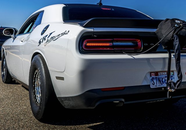

345/30/20, 20x12" wheels, Phillips Lil Devil Flares.

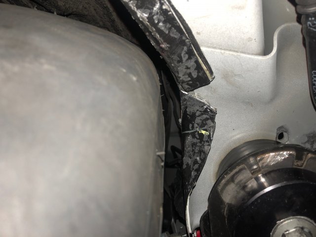

315/60-15 M/T Pro. Absolutely the biggest thing you’re going to get in there without ripping out the entire inner fender structure. E89A99F6-6B86-41F3-A177-F085C93A3C6D.jpeg 667E88C0-D6F7-4C69-AB1B-F49273D4E90E.jpeg

Yea, you just can't get anything wider than a 315 Nitto in the back without doing major work inside the fender wells. I'm frustrated that Nitto doesn't make a drag radial wider than a 315. I'd even be happy with a tire compound between the 555R and the G2 for daily driving just need it in a 335 or 345 width.
