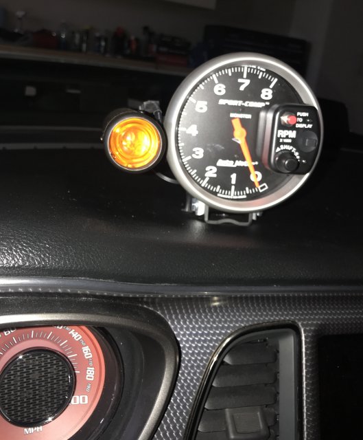

I have a Autometer tach with a shift light. Late model cars like ours require an additional adapter box wired to the coil packs for the tach and shift light to function accurately. Not a simple three wire connection like with older cars. 58EA4127-C20F-4646-8683-F6131E967562.jpeg

Thanks Marc, that’s a serious racing tach there. I don’t need anything so large and purpose built. The beauty of the Raptor is its 2 stage capability.
