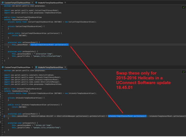

It's been several years trying to figure this out but I was able to finally track down the issue with the Performance Pages Gauge 2 Dashboard swap.
I've got the coding problem figured out. The challenge is getting the UConnect software repackaged properly so the car will authenticate/take the update.

Issue (2015-2016 Hellcats)
UConnect 17.11.07 introduced a change in how the Performance Pages resolved sensor data. The updated code mapped the Performance Pages’ temperature gauges to incorrect sensor URLs (e.g., "LTR_Coolant" and "IntkAirTempIntrClr") referenced in the I/C Coolant and Intake Air Temperature Dashboard Views, resulting in a mismatch between the displayed labels and the underlying CAN signals.
The instrument cluster was unaffected because it continued to reference the correct CAN sensor IDs. This is why cluster readings for I/C Coolant Temp and Intake Air Temp remained correct, while the Performance Pages began showing cross-mapped or inverted values starting in 17.11.07 and all later releases.
Potential Fix
Dodge needs to patch the Performance Pages App for 2015-2016 Hellcats with the following corrections to Gauges 2 Dashboard files.
File Location 2015 (LA Challenger):
UConnect 18.45.01 version > swdl.upd > secondary.iso > usr > share > xlets > kim_packages > KIM18 > xlets > 7DEC7834-535D-47B5-BD33-695477EDCD57 > prog > jars > GSkills_MY15_LSeries_v02.01.01_FIT.jar
File Location 2016 (LA Challenger, LD Charger):
UConnect 18.45.01 version > swdl.upd > secondary.iso > usr > share > xlets > kim_packages > KIM22 > xlets > 7DEC7834-535D-47B5-BD33-695477EDCD57 > prog > jars > GSkills_MY15_LSeries_v02.01.01_FIT.jar
Current in 18.45.01
IntakeAirTempDashboardView.class -> IntakeAirTempICSensorModel.getInstance()
CoolantTempICDashBoardView.class -> CoolantTempICSensorModel.getInstance()
Software Patch Needed (2015-2016 Hellcats only)
IntakeAirTempDashboardView.class -> CoolantTempICSensorModel.getInstance()
CoolantTempICDashBoardView.class -> IntakeAirTempICSensorModel.getInstance()
This is because the current CoolantTemplCSensorModel references "LTR_Coolant" and IntakeAirTempICSensorModel references "IntkAirTempIntrClr". When the wiring was changed from MAF to IAT sensor in 2017, the signal referenced by "LTR_Coolant" is now the post-intercooler charge air temperature, and the signal referenced by "IntkAirTempIntrClr" is the coolant temperature flowing through the low-temp coolant circuit and intercooler pump.

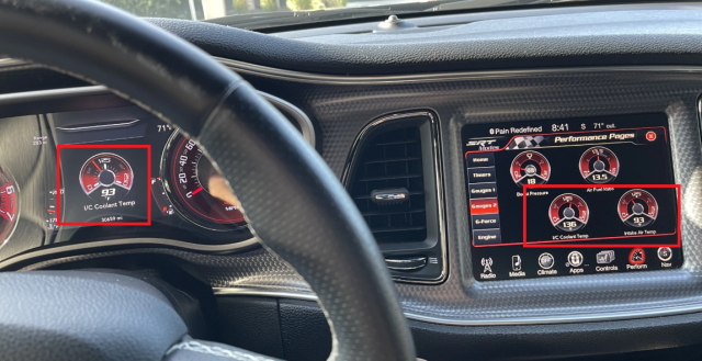

I don't believe this is an issue with M6s???
My 2016 M6 Hellcat reads correctly. I want to change to a 2017 screen which has CarPlay, but I’m worried about losing my intercooler temp reading. ??
8,508
7,437
Get this - m6, 2015. My gauges displayed correctly. Converted the car to A8 and guess what? The gauges are flipped. It has to be something in the A8 config
16,882
52,886
My 2016 M6 Hellcat rest correctly. I want to change to a 2017 screen which has CarPlay, but I’m worried about losing my intercooler temp reading. ??
Check with Ray, but I think somehow this is only an issue on 15/16s
3,679
8,687
Mine reads correctly now, I don’t want to mess it up changing to a 2017 screen. That’s my concern.

Ok, I want to confirm this, but I also want to make 100+% sure I understand what you've all been saying this whole time...
I want to confirm this because having never seen it, it is foreign to my understanding, so, you know, certainly is a fickle thing...
My center display gauges do in fact match the gauges in the Uconnect, and what you're saying is that the center driver's display has gauges swapped, correct? (I know, but I'm just being as clear as I possibly can be, being that MINE DO MATCH...)
My HC is a MY2016 M6 Challenger with Uconnect 18.45.01
Glad I don't pay attention to that kinda stuff...:eek::eek::eek:;)
06SRT10NR
#1148
1,540
2,542
Knobnation
back to the topic, '15 HC M6 ver 18.45.01 and the ref'd gauges are reversed
