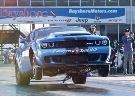

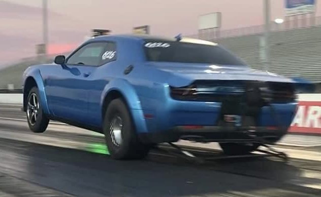

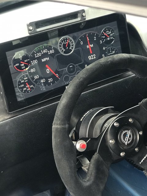

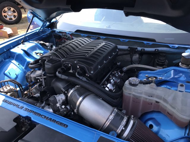

“Close to $300k” is what he told me he’s got in it. After two years of building it…. he’s decided he wants to spend his time in other pursuits 🤯. This is not a for sale ad. Just a heads-up in case somebody knows somebody who might be thinking about going in this direction and might want to save two years and $100k. I can provide build details and contact info. Car ran a soft tune 8.0 at 169 mph in Houston and has a fresh zero time motor (new heads) and zero time T400 and billet converter. He’s asking $135k 62DE05A7-0035-4024-87CF-6261FAD2E69A.jpeg 2C6C8C38-8D0F-4A18-AF88-F1915032CF0F.jpeg 3C312121-C49F-4A1A-B032-5A6559EF1371.jpeg 59C712CA-A226-4A69-86A4-AEDFAC001DF3.jpeg
