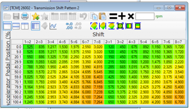

So, what tables in hp tuners should I up? I was going to multiply by 1.05. But there are many shift scheduling tables. I do not want to cause myself too much work. Can someone point me to the exact tables that I need to change?

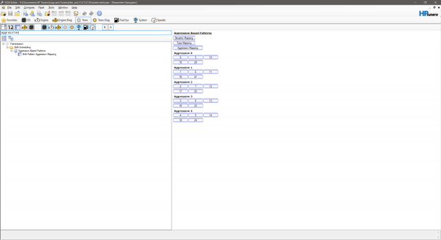

So I'm glad we spoke before you went and did this yourself. Multiplying the table by that number in your original post wouldn't have netted you the results you wanted. There are a few tables and no magic to edit them all, it is a painstaking process so lets get into it. When you open HP Tuners, use the keyboard combination ctrl+n to bring up the navigator, then type in "aggression". It will give you a screen similar to the following:
Aggression 0 is normal, 1 is performance, 2 is Sport, 3 is Sport Max and 4 is Track. When I was tuning my TCM I left normal and performance alone, those are the safe settings for daily driving. Aggression 2, 3 and 4 are the usual suspects when it comes to doing fast thing so those are the tables I recommend changing. So when you open up a table it make look like the following:
However those numbers are not RPM of the engine they are RPM of the Output Shaft Speed (OSS) of the transmission. You have to convert these values to engine RPM. I have a nice fancy excel from the Tuning School but they are kind strict on sharing class materials so I present to you from my google docs, the same thing... 🤣
https://docs.google.com/spreadsheets/d/1D7HzGC9Dm_3YSdamLiam4ZV7UmMUUdU7m5F6-07Qelc/edit?usp=sharing
You do not want to really up anything below 79.9 as you may not have the shift pressure to shift it correctly. You made a comment in the middle of me creating the excel spreadsheet so please don't do what you think you can do with just percentages, it's not how these tables work. So in aggressions 2,3,4 (for all the tables) make the changes for 79.9 and up and you will be very happy. I will include a post on shift pressures soon.

So getting into the theory of this, if you want a shift at 6300, change RPM to 6000. Depending on health of trans and shift pressures it may take time for the commanded shift to occur. Log this in HP Tuners. @Speedy! taught me this tidbit. If it blows past 6300, command the shift earlier or increase line pressure.

I had a tune and it was already at 1500 at 1-2 in the 100 percent pedal position. I think someone told me it will take the 90 percent pedal position which is 1348. It will ignore the 100 percent and up pedal position. 1348 x 4.71 is 6350. I know 1-2 over shoots this by at least 250 rpms.
View attachment 59203 I
I now see from 79.9 to 100.6 you are keeping them the same. That way no matter where the internal software is referencing the shift pedal position from 79.9 to 100.6 you will be getting the same shift rpm. Very ccol.

Yeah, in first gear, by the time you are already putting the pedal to the metal it is wanting to shift so you prolong first gear by raising the shift points from that accelerator pedal % towards 100%. This has been my experience with my 3.09. Those numbers btw are just reference data, they are not what I currently have in my tune.

1404/2109/3142/3952/5080/6400
For 1 to 2 6600 rpm. But it will be 6800 or more. It will blow past that 6600 rpm commanded shift.

Be cautious of 1st gear shift points.
Like you stated, its going to blow by that number, and we've had at least one member potentially lose a motor to this scenario.

Thanks for the warning. I will down that to a commanded 6400 rpm shift. Then it will probably shift at 6600 to 6800. Bull are you familiar with tuning the transmission through HP Tuners? If so, any other recommendations are welcome. In the shift pressure under general I raised everything modestly by 5 percent. I heard to start out small. I am going to keep all the other safeguards on with torque management, etc. (If you do not understand something leave it alone is my motto.)

lowered 1/2 to 1362. Bull, you are correct. It blows by the commanded shift point in 1 to 2 by a lot.

so I banged the rev limiter really bad on a few shifts in first, id start with 6200 and see if it blows past it

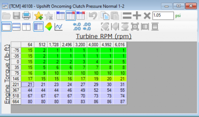

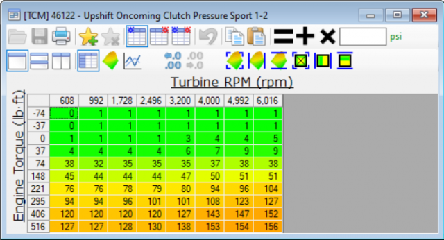

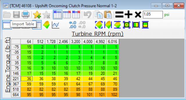

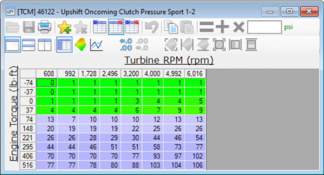

For shift pressures the only tables you need to touch are Oncoming Clutch, I did Normal/Perf/Sport/Max. For Normal/Perf I did a basic mild change. Make sure all changes are in PSI!
Anything else could adversely affect your solenoids. So the mild changes for Normal were select all rows from 221lb ft to the maximum and and 15 psi to them all by using the plus icon.
Stock is above, mild is below.
Do this for all the rest of the tables in Normal/Perf. For Sport/Max I did a very aggressive change. Add 25 PSI from 75-146lb-ft and then 50 PSI from 221lb-ft to maximum.
Stock above, aggressive below.
With these changes, your trans is going to be shifting like a champion. I have many a log highlighting the crispness of these changes, nice high peaks and correct drops. The trans will shift hard but that is expected.
