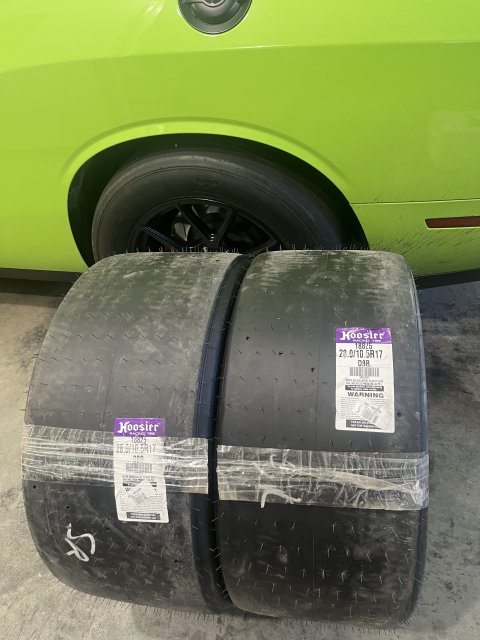

Got these. Made ALL the difference. 10B99F27-345C-4498-946F-A8EFDF9CE5F4.jpeg

Hi Linda! Unfortunately, I never kept any slips from that place. My best pass Sunday was 7,14 @ 96mph. That's down from 7.60s with drag radials. I never competed there over the poor prep. Reguardless of what I dial I feel confidant it can be repeated. Now gotta work on that reaction time!
