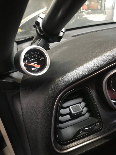

As far as puller mounted gauges… Z’s right. Bar mounted pods are available. Here a old pic of my trans temp gauge. F1E4F26F-17F5-4D8F-A603-6304E5554387.jpeg

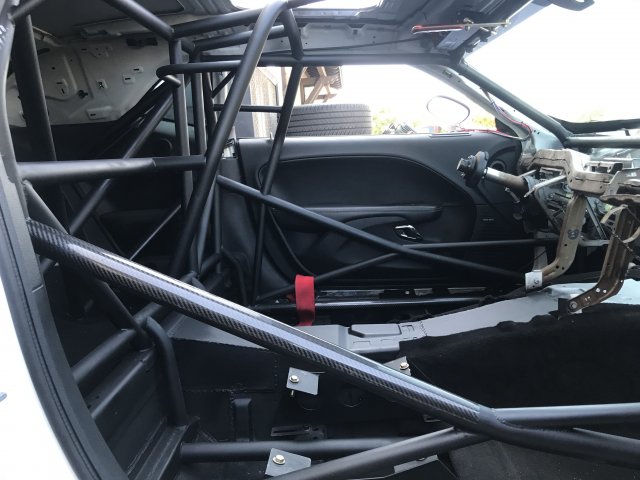

This is my cage when it was 8.5 cert. In street mode with the drivers side door bar out. Pretty easy to live with. 8F8961F6-34F3-4DED-8F3F-6D2C1F094847.jpeg
