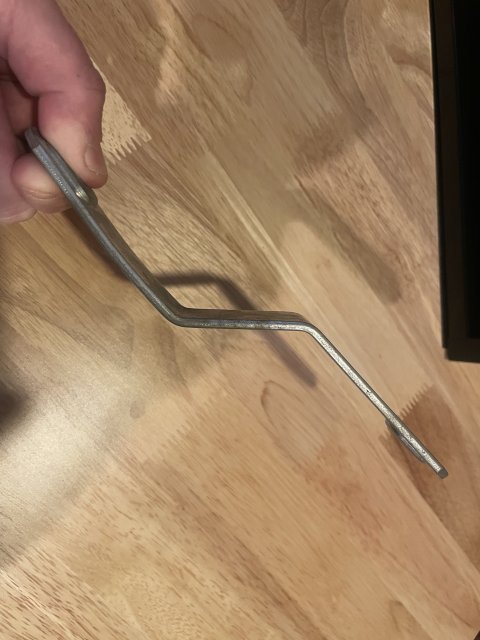

Anyone remove the bottom of their mopar rear seat delete without destroying it? Doesn't want to budge without crunching. Looking to redo a few in tank butt connector for the fuel sensing unit. Any pointers would be appreciated. Thanks
I used this
As a pry tool.
Popped right up
17,324
54,225
Does it engage with the seat brackets in the same way the seat does?
Push back, pull up? Easy with the right move, 'won't come up without that backwards push first.
