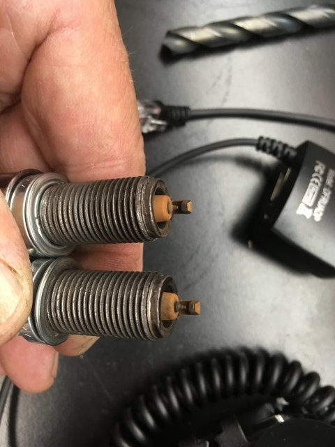

I've questioned what the issue is with the orange tint from MMT. I did some reading on it a while back. There was a thread on the other forum from a guy that put Boostane in every tank and a year later gave an update. No fouled plugs or any sensor issues and he used it EVERY tank for a year according to his report. I have about a half can left in my cabinet in the shop from where I tested it. It does work.

@Jack_Toepfer. Yes I was referring to the arbitrary color. It shouldn't matter if it works. As long as no oil, pitted or cracked porcelain and knock sensors are reading good. Yes also agree the plugs, chambers, exhaust pipes etc. are also coated, even when not orange, but I don't know what's a harmful coating for sensors and cat's. If the orange (MMT) coating is not harmful I wouldn't be bothered a bit.

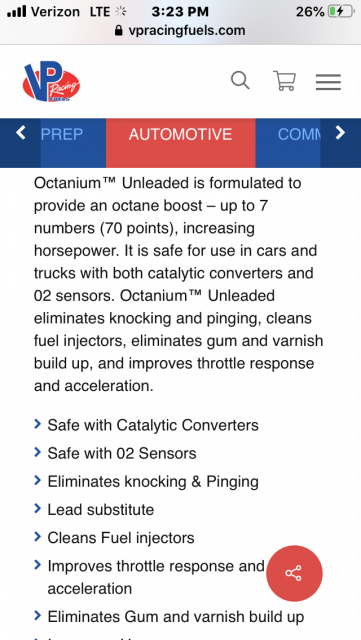

Gents,
At great risk here of a rebuke (new guy) reading this post I remembered something about it in my 2019 Dodge Challenger SRT manual. Here are the two excerpts;
"Methylcyclopentadienyl Manganese Tricarbonyl (MMT) is a manganese-containing metallic additive that is blended into some gasoline to increase octane. Gasoline blended with MMT provides no performance advantage beyond gasoline of the same octane number without MMT. Gasoline blended with MMT reduces spark plug life and reduces emissions system performance in some vehicles. The manufacturer recommends that gasoline without MMT be used in your vehicle. The MMT content of gasoline may not be indicated on the gasoline pump, therefore, you should ask your gasoline retailer whether the gasoline contains MMT. MMT is prohibited in Federal and California reformulated gasoline."
And on the same page 395, Technical Specifications;
"The use of fuel additives, which are now being sold as octane enhancers, is not recommended. Most of these products contain high concentrations of methanol. Fues system damage or vehicle performance problems resulting from the use of such fuels or additives is not the responsibility of the manufacturer and may void or not be covered under the New Vehicle Limited Warranty."
Don't shoot the messenger!
3,686
8,693
#53
Octanium Unleaded formulated a bit different then past octane boosters, it does work well.

Orange crap on everything would be a pretty good indication of MMT usage, and grounds for voiding Mr. Warranty. You might be able to pull and change 16 plugs (brand new - LOL) but not every nook and cranny full of Dorito dust. That said, I am not buying the addition of methanol to the mix being causational or detectable in the face of a failure - that's a stretch.
