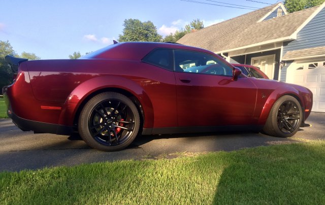

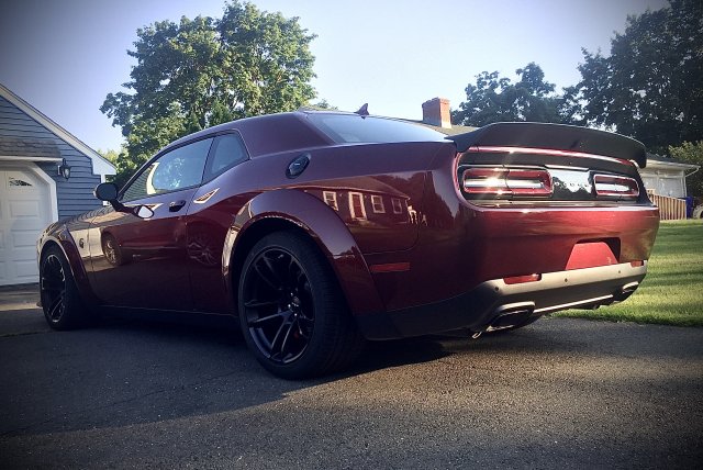

Unrelated but you got her today?! Did you post pics and how you like her?
2,287
5,366
Ya picked it up today. This thing is the cat’s meow. I love it.

Killer man! Congratulations!

Damn! That is beautiful. Looks fast sitting still. Congrats Slowpoke!
