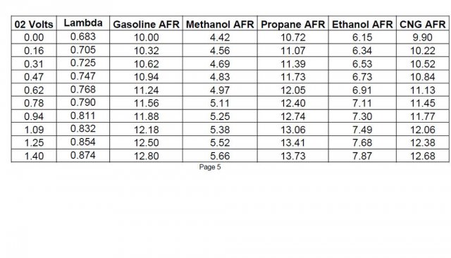

That concept does make it easier to comprehend it, but when I was reading they were giving it an arbitrary number of 1,then adjusting off that number . But is that value different for all fuels? Like does each fuel have it's own value of one to adjust from? Don't want to take up your night. I'll get it.
Lambda is one scale of measure for all fuels and/or fuel compositions. It is the relationship of oxygen to everything else downstream of a combustion event. That isn't to say there is a magic number for all boosted engines (like 0.740 Lambda) you still have to tune for your combination. It is just easier to tweak moving in increments of 10th or 100ths of 1.00. As opposed to doing a bunch guess work on the gasoline scale with other shit mixed in.
Again, I understand the ratio of A/F ratio of gas to the value of 1 the best. Have never even played with the other fuels but I get the ratio's. Like A/F of 12.8 (gas) is 87.4% of the "1" lambda (i.e. the most efficient 14.7 A/F combustion ratio for fuel) . I don't have HP tuners or DS but will prob start playing with that some time in future. I'm guessing they all use this as a bases not A/F? Also, 02 volts?(have no idea) 02 sensor reading? Thanks for the chart. You don't have to feel obligated to be my personal tutor, appreciate the input and info.
I don't mind helping. Typically O2 volts are for narrow band O2 sensors, which Hellcats don't have (but most GM products suffer from (along with open loop tunes)). But, in the case of the HCs they do use Lambda as a basis for their tunes and are closed loop corrected using real-time info from the WB02s.
For anyone venturing into tuning it is important to remember these are oxygen sensors, not fuel sensors. They react to residual oxygen content and don't care what other crap is suspended in the exhaust. Some people get so wrapped around the gas-scale they forget their purpose. These sensors are some of your most powerful tools.
