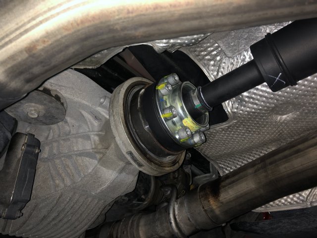

No problem if you need any info on this let me know. I even put torque seal on the bolts “just to be sure!” 7B192EFE-1D51-4D72-B08C-886FAE42BC31.jpeg

So it was a direct bolt in?
100% zero issues. Now it’s only good on challengers. If anyone has a charger this will not work.

No problem if you need any info on this let me know. I even put torque seal on the bolts “just to be sure!” View attachment 7574
What were the bolt torque specs front and rear?

49 Ft. Lbs thanks

Did you use new bolts (as per Rayzazoo's PDF) ?

Anyone know if the bolts need replacing when doing a driveshaft swap? It appears the DS on #Kotta376 's use 8 Torx style bolts. Everything I've read regarding DS bolts keeps referring to 3 "pink bolts".
