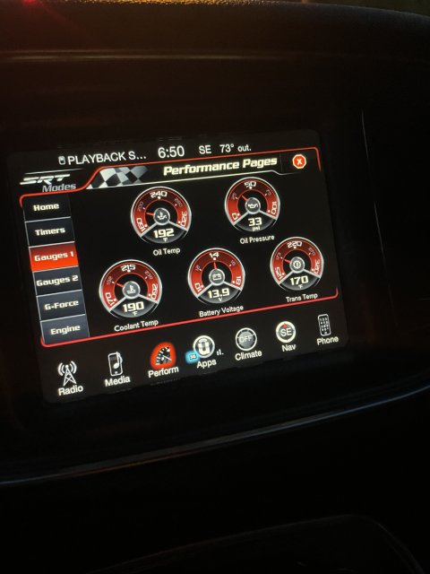

Yesterday while driving the car under acceleration would shut off and I would get a red lightning bolt in the dash. Upper left. Some have said the alternator could be going or that the throttle body needs a re-learn. Has anyone encountered this? While it happened, I put on the performance pages to see what was going on and car looked healthy.

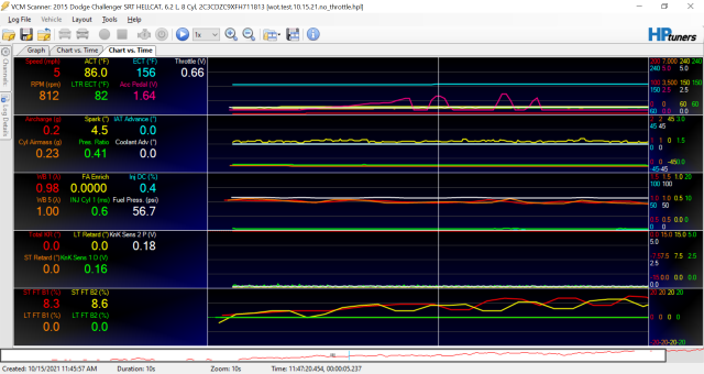

Yeah, just looked at the logs this time. For sure was an issue with throttle and accelerator pedal not syncing. The re-learn made it happy, which means I'm happy, which means racing tonight!
Purple line is pedal, white line that doesn't move is TB. Good thing I was with the laptop and only 60 ft from the house when I hit the gas and it went no where.
