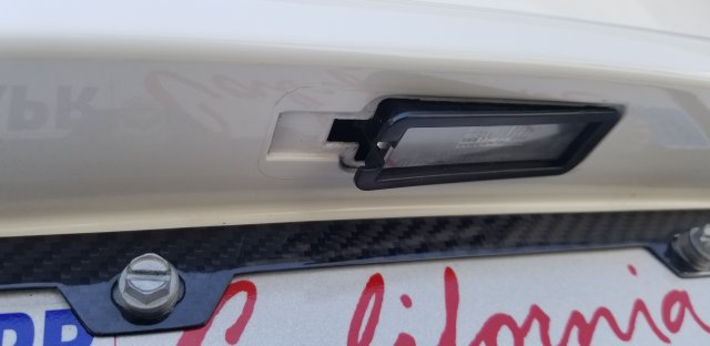

So basically, asking if anyone else has had an issue with the rear Tag light falling out of their new Challenger?
Mine was hanging out today. Tried putting it back in, but it would just fall back out.
Went to dealership, manager looked at it, was about to order a new one, and was actually able to snap it back in.
Had to slide up in, then move to the right, then left, to get it to snap in.

Yes...are you talking about license plate light? If so, cheap plastic clip that holds it. Must have broke mine wiping car down. Ordered and installed myself.
4,662
24,176
Yea, mine was hanging out when I received my Redeye. I ordered an after market LED one and replaced it like I had done on my Hellcat.

Mine is a 2017. Looks like same part. Looks like it is in place, feels properly seated. Hope urs stays in now.
You still have order/part number?
