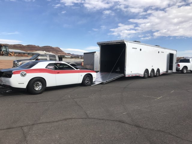

1500 will tow a Hellcat on a open trailer without any problem. 2500 will tow a 18000 lb trailer without any problem. I can say that because it do it with my 2018 Ram. I’m out west where the mountain grades are real. I’m towing a 34’ with full bath setup. Loaded with big generator, two airs, water, fuel, tools and a golf cart in addition to my car. FC712396-065B-4329-8960-5429CC65333F.jpeg

Yeah. I forgot to say…. Whatever you do…. Don’t buy a EcoD. Another thing…. I have air bags on my 2500 and that makes a big difference. I also tow at or below the speed limit and make sure all my brakes are good. Including the trailer on all six wheels. I’ve got 95k miles on the truck now (about 30k of it towing) without a problem.

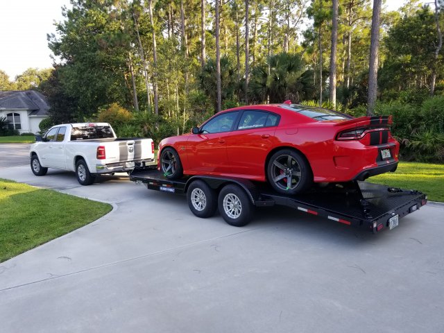

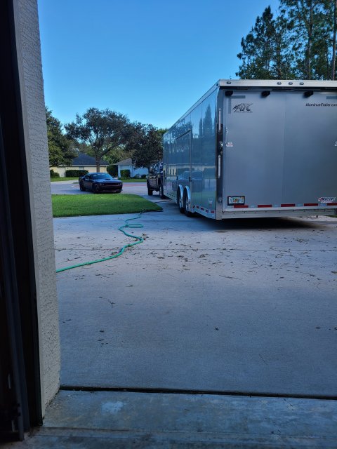

Had both. 1500 with open is much easier.

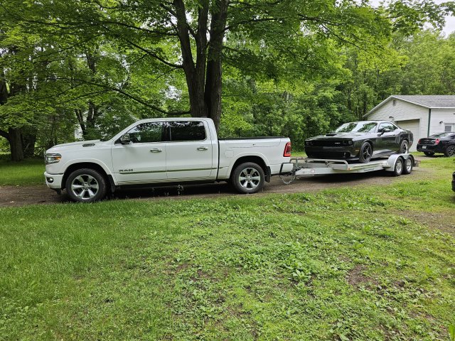

I tow mine with a 1500 on an open trailer.
If you go that route then I recommend a ram with the air suspension. My buddy overloads his all the time with a 24' enclosed trailer.
While I don't condone that he has had no issues with any of his trucks with air suspension. We live were it should be a problem in the winter at least. I am replacing my truck with another with air suspension. Nothing better than a truck that stays level. The regular suspension truck sags to much for my liking. 20230618_091945.jpg

Air suspension is great, but with a 1/2-ton a weight distributing hitch is almost mandatory.
Well, technically it is, according to Ram.
1,464
3,691
weight distributing hitch mandatory for sure, and one with sway control interfaces as well for any extended high speed pulls.

I don't have a weight distribution hitch.
Finding one for my trailer isn't easy up here.
Plus the sway control on the truck has never kicked in. My tongue weight is only 640 lbs.
So nothing crazy. The newer DT model tows better than my old ds model which had a weight distribution hitch on a steel open trailer.
I'm not arguing with the other concerns and statements it's just my .02$.
I do however have lots of experience towing stuff with inadequate equipment from when I drove a wrecker. So I am pretty comfortable towing with the new stuff that is way more capable than the old trucks, one tons included.
