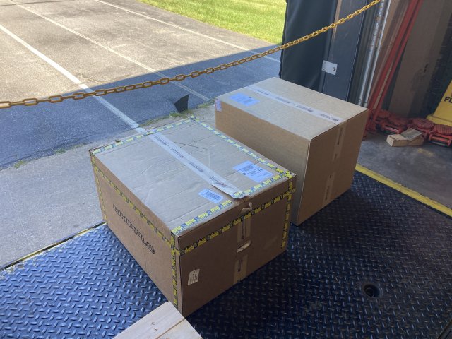

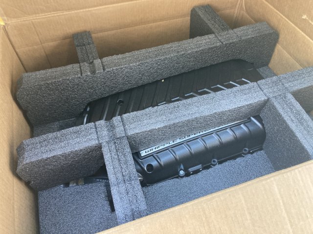

We received a few pallets of some fresh Whipple 3.0L units. We have a ton of these blowers IN STOCK and ready to ship at www.HHPRacing.com !

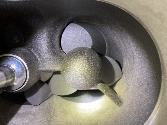

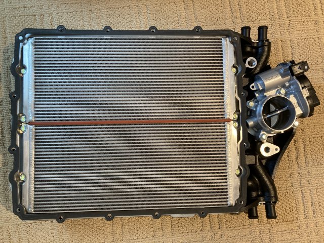

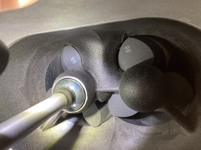

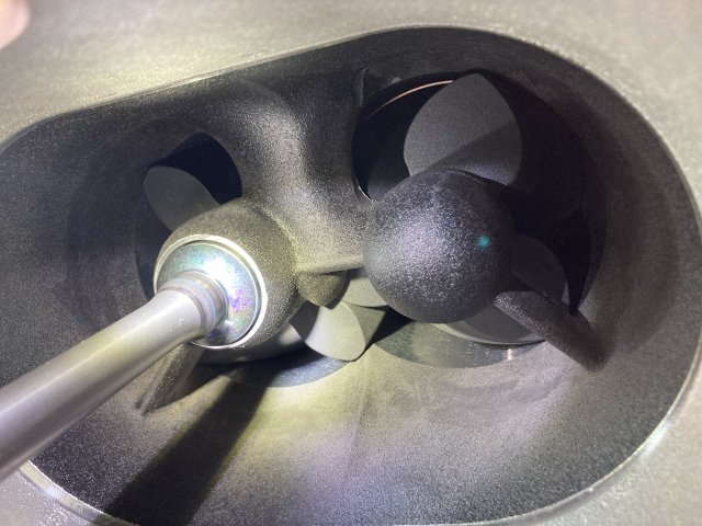

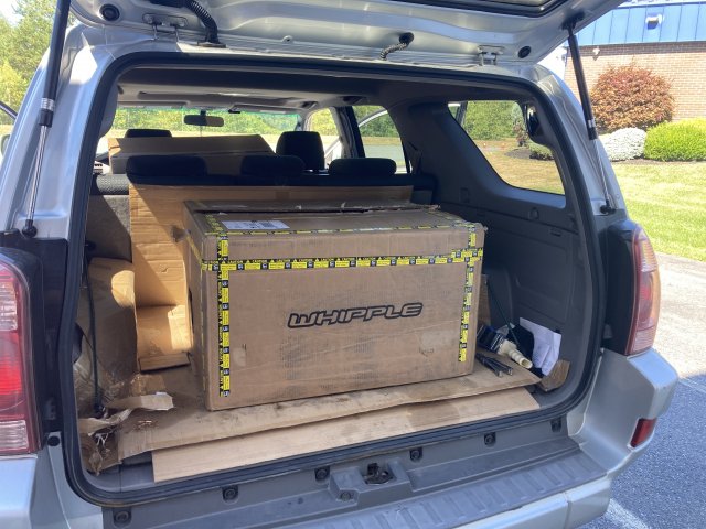

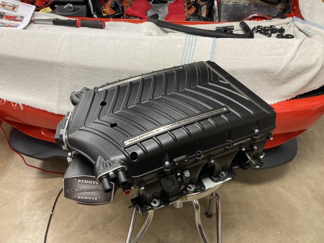

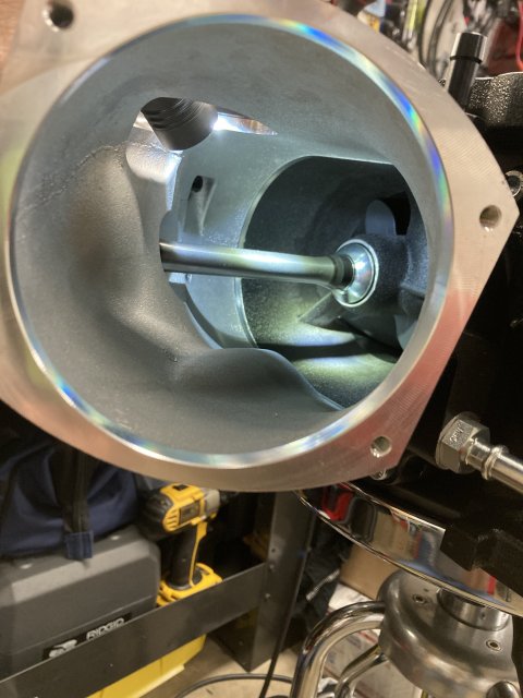

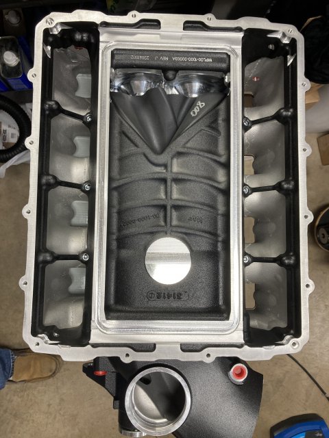

I got the first one :)
I Was making 950 wheel on my ported 2.4 IHI 2.72 upper + 10 lower IHI before on pump E83 so we’ll see where this gets to on about the same boost to see how much more efficient they really are
1906F4D4-4027-470C-BD75-315BAD6BD6E3.jpeg 11C5D330-7C59-4A51-A085-BC02CDE7F981.jpeg 5668EE7C-11E3-41E9-BF52-66AEBF68E299.jpeg 0D0F1DCC-C72D-46CF-9729-3519D639A16F.jpeg 690ED094-F544-41D1-BD5F-FBE5E4C96FAE.jpeg 0AF6A439-289A-4051-B36B-397EAC107B8F.jpeg 815A4E7D-6AC4-4355-A771-3040A32F2F7B.jpeg 1039EB88-C02D-4555-938C-FB93A1B1396B.jpeg DB65FC8A-B579-464D-A10C-136EB1C7CCB0.jpeg 0EC5AD3E-C93B-4EDF-9808-AA4D018A36AD.jpeg
Should be on the Dyno next week If all goes right.
