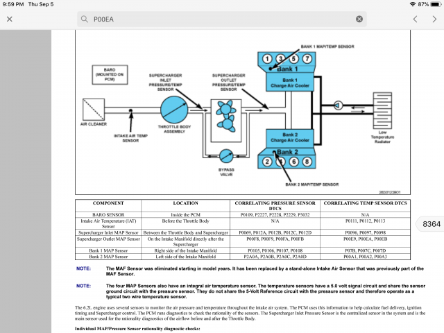

Question - I've received this code along with the dreaded P1620 on a few quarter mile passes lately. Since I'm pulling the blower to install spacers/blanket I plan to replace the offending TMAP sensor.
Can anyone confirm which of the 4 sensors "sensor 3 bank 1" represents?
When I look up P00EA, it references the sensor on the driver side, middle of the blower (intermediate TMAP). However, when I looked up the supercharger removal procedures the sensor on the front of the blower on the passenger side is referred to as 'bank 1'.
Want to make sure I replace the correct sensor.

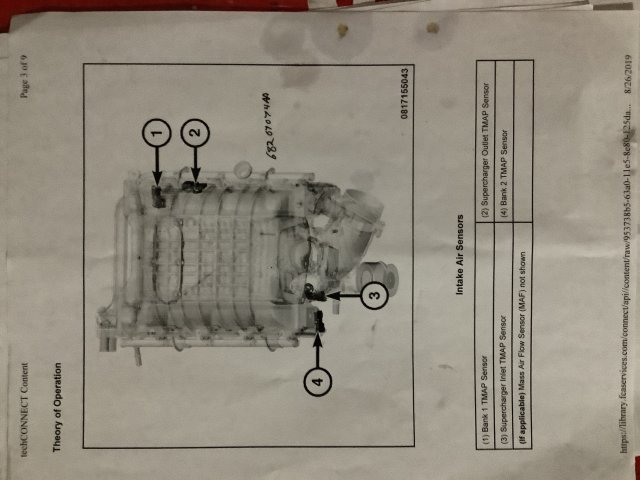

Thanks, I hadn’t seen that diagram.
However, I’m still not sure which of the 4 sensors the code is for... looking up the DTC, it calls out the intermediate TMAP sensor (#2 above). The ‘bank 1’ sensor is called out as #1 in the diagram above. And the Dodge service manual refers to #4 above as the ‘bank 1’ sensor.
I’m so confused...

7,471
19,633
Diagram says "Theory of Operation". We're not really sure how it works LOL

Thread Starter #14
Found this which appears to confirm its the intermediate TMAP. I’ve already got one inbound, so may just replace and see if that takes care of it for now.
