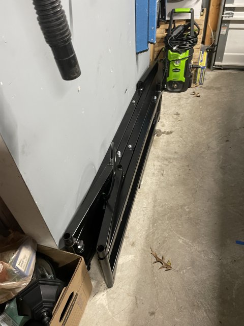

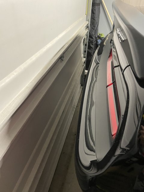

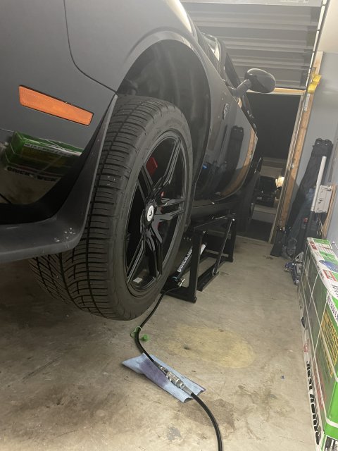

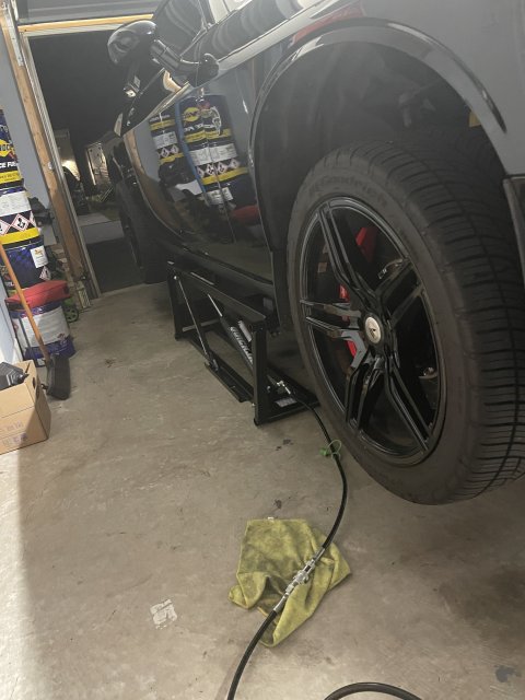

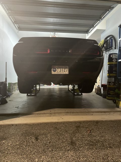

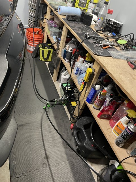

Permanent location of pump and cable route. Also figure out radial shift and storage.
1903B8E7-5965-4E6A-A191-93589A0419AB.jpeg E54D6B9A-AF80-47AC-A5CB-85E697C575E6.jpeg 7446CF33-6290-490C-A6C5-A0877A7BAAC5.jpeg 87C38CF5-B87F-4195-BE7E-C5FB7794BC09.jpeg
