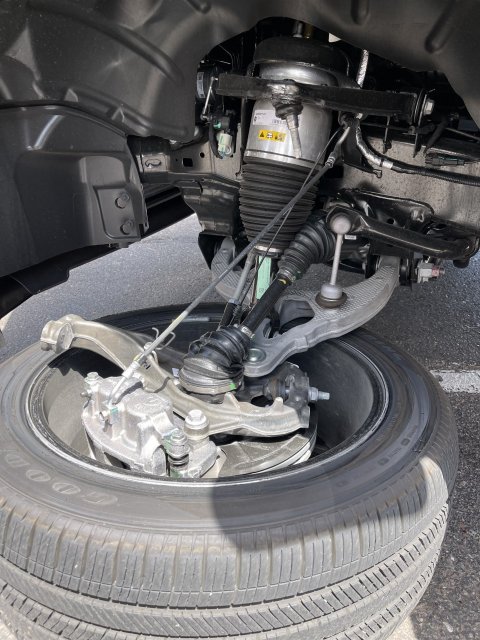

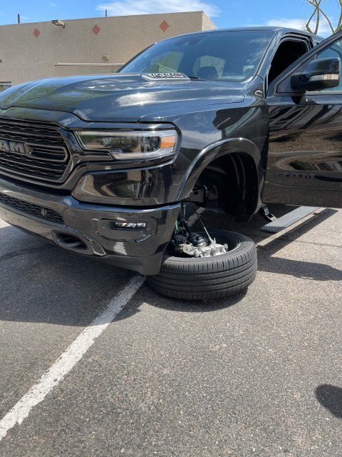

My friend bought a new Ram in Phoenix, AZ. He lives in Tucson. The truck is only one month old. So this past week they, him, his wife and twelve and fourteen year old boys, took a trip to Flagstaff. They stopped off in Phoenix to grab a bite to eat. As he pulled up in line his freaking front driver's wheel fell off!!! When the tow truck driver looked at it they discovered the bolt from the upper control arm was missing!!! A week before my friend noticed the steering wheel was off. He brought it in to a local dealership here to get it fixed. They did an alignment. But apparently they did not see the bolt was loose or missing. Thank God this did not happen at speed!!! I have never heard of this on a new truck! What is going on with quality control??? I will post a couple of pictures. He gave me a ton of them.

There is also the chance they loosen it to do the alignment and didn't tighten it

Mine went loose at 140 mph 😬
Alignment shop forgot to tighten my control arm down. It felt fine at first but as soon as I did a hard launch it must have loosed even more causing the aad drag pack arm to pop out. It was holding on by one thread.
alignment shop messed up. Glad it wasn’t at speed. It was scary feeling when that tab popped out.
That suspension won’t have the tab.

Maybe sabotage? Does he have any mortal enemies? Wonder if there was an inspector’s paint mark on it? These things are usually checked and marked as checked at the factory.

Hope not. We would be talking about an extremely serious crime. He is a likable giving person. I met him at the Tucson track 11 yrs. ago when we both had g8s. Probably just negligence at the factory.

When the tire fell off my jeep, it was because someone was trying to steal the tires, not a factory fault.
Not saying that is the case here, just saying who knows what happened.

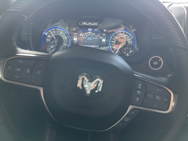

He said it was off. Picture attached. Then he brought her in for an alignment. If I said loose I misspoke.

I am betting it wasn't tight from the factory, and just worked its way off
