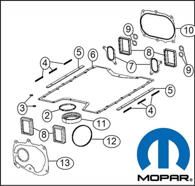

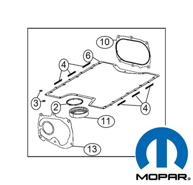

So after speaking with a few people that have done the swap and with the mileage of the SC I've decided to replace the gaskets while I have it open, think of it as preventative maintenance. When looking on the HHP website I see the following kits:
https://highhorseperformance.com/mopar-hellcat-supercharger-lid-gasket-kit-68267540aa/
Versus
https://highhorseperformance.com/mopar-hellcat-supercharger-gasket-kit-68267539aa/
I am thoroughly confused as the kit with less pieces costs more across a lot of dealers sites. Also I can't find either part number on the official dodge parts lookup. Anyone that have any experience with this care to chime in, any help is appreciated (I did a search and these were the results: https://www.hellcatforum.org/search/272777/?q=supercharger+gasket&o=date).

I reached out to HHP and purchased https://highhorseperformance.com/mopar-hellcat-supercharger-gasket-kit-68267539aa/ Apparently they get the question I posed all the time, they don't even have the kit with less parts. Also that video has been on my playlist for a while to watch. He does mention that if you have a higher mileage HC that it's a good idea to replace them, just like the advice from others on this forum.
