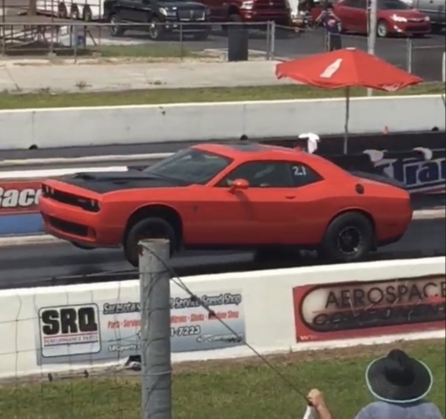

Hellcat Cuda
#1131
465
811
S.F. East Bay
Whoa, crap! Now THAT is hooking! 15" conversion in the back? What is done to your suspension and/or rear end to support such a nice launch?
#1487
89
141
ellenton
2016 mango hellcat challenger
Demon Springs - 15" conversion - 315/60 radial pros - stock 2.62 with brace - Sphon adjustable arms - and my own chromoly toe links
here's a video
